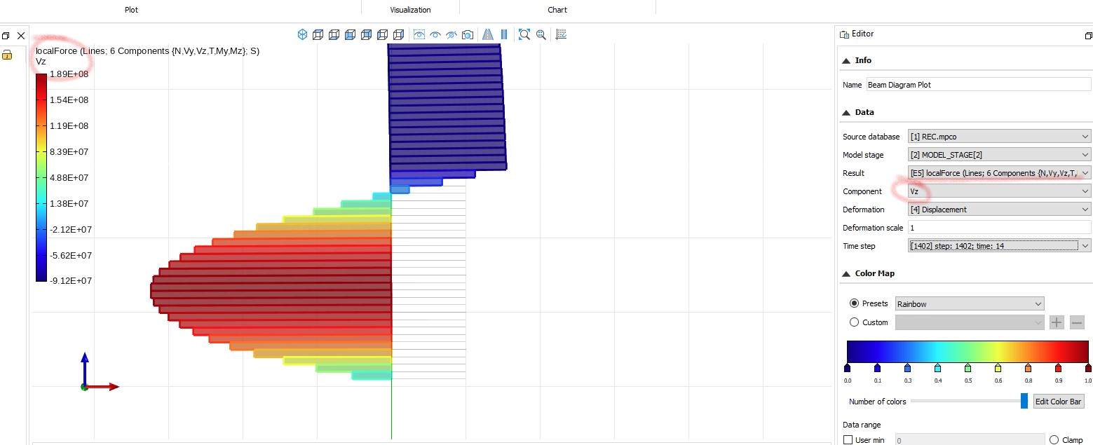

on a similar topic, using STKO v4.0.0, I would like to extract the local (shear) force of a beam element. I am using "Force-Based beam-column" elements, with Standard Integration Types (Lobatto, 5GPs), with Elastic section. While I can visualise the local shear, I cannot extract the data in a tabular form via the postprocessor. Can you please let me know if there is workaround?
Stavros

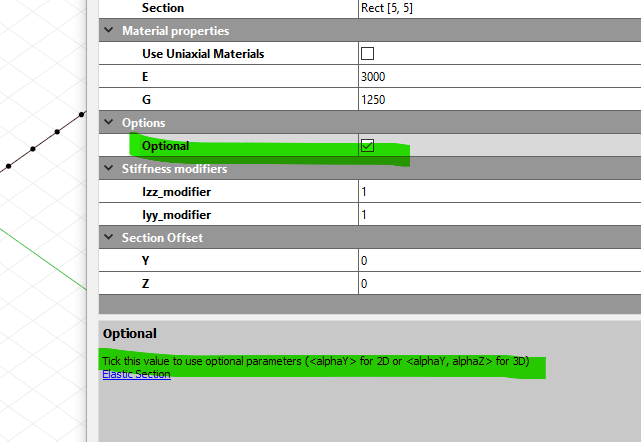

Post by STKO Team » Mon Dec 09, 2024 9:58 am
Check this option to make the force-beam-column shear-deformable:
Record section.force, and on gauss points you will be able to see and extract the transverse shear.
Note: When the beam is shear-deformable (Timoshenko), shear deformation and force are available at the section level.
When it's not shear-deformable ( Bernoully ), you will only see the shear forces at the element level (force or localForce) due to equilibrium
