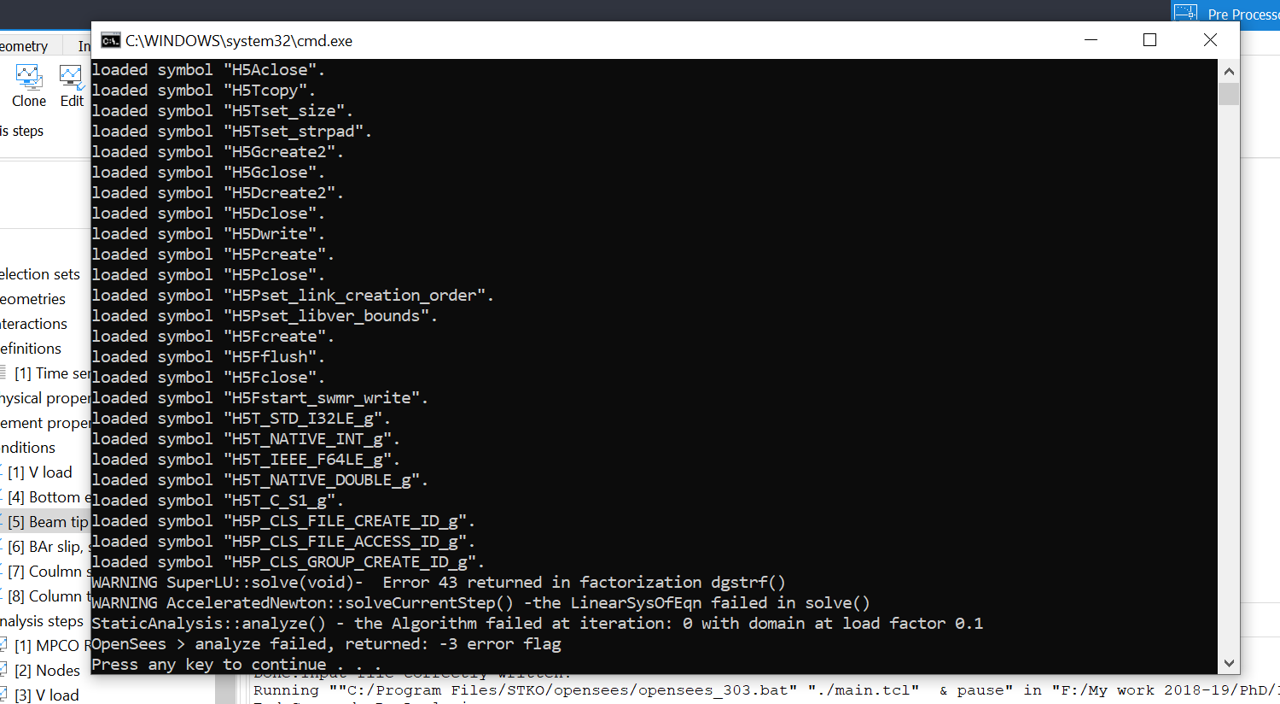

I have applied only a constant axial load on the column and tip load on the beam's tip. The top-end column has two DoFs (Rz&Dx) and the bottom end has one DOF (Rz). Screenshot of the window is also attached.
I receive the following error when I run the analysis:
WARNING SuperLU::solve(void)- Error 17 returned in factorization dgstrf()
WARNING AcceleratedNewton::solveCurrentStep() -the LinearSysOfEqn failed in solve()
StaticAnalysis::analyze() - the Algorithm failed at iteration: 0 with domain at load factor 0.1
Press any key to continue . . .

You should give more details about the boundary conditions. From what you wrote, I understand that you are doing a 2D analysis, 3 DOFs per node (Ux, Uy, Rz) and you said that the bottom node has Ux+Rz fixed, while the top node has only Rz fixed. This means that your model has an un-constrained rigid body motion in Uy. Thus the error saing that your system is singular.

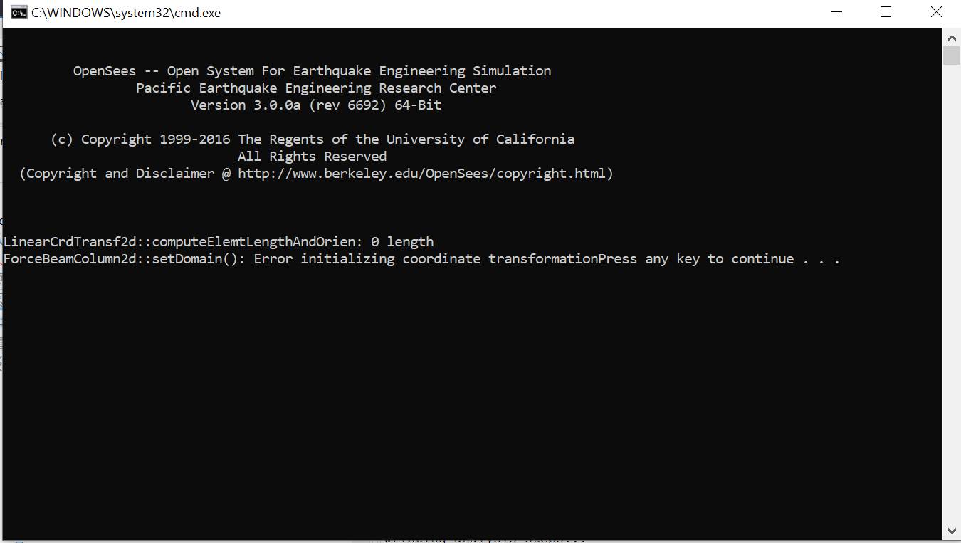

Now, when I run analysis I receive the following error( also shown in the attached screenshot):
LinearCrdTransf2d::computeElemtLengthAndOrien: 0 length
ForceBeamColumn2d::setDomain(): Error initializing coordinate transformationPress any key to continue . . .

Dear Asad, that error means that some beam element has a length = 0. Therefore the linear coordinate transformation raises the error.
Please, post your file here so we can have a look.
However I think that you modelled your example in a plane other than the XY plane. Note that in 2D problems opensees only considers the X-Y coordinates.
