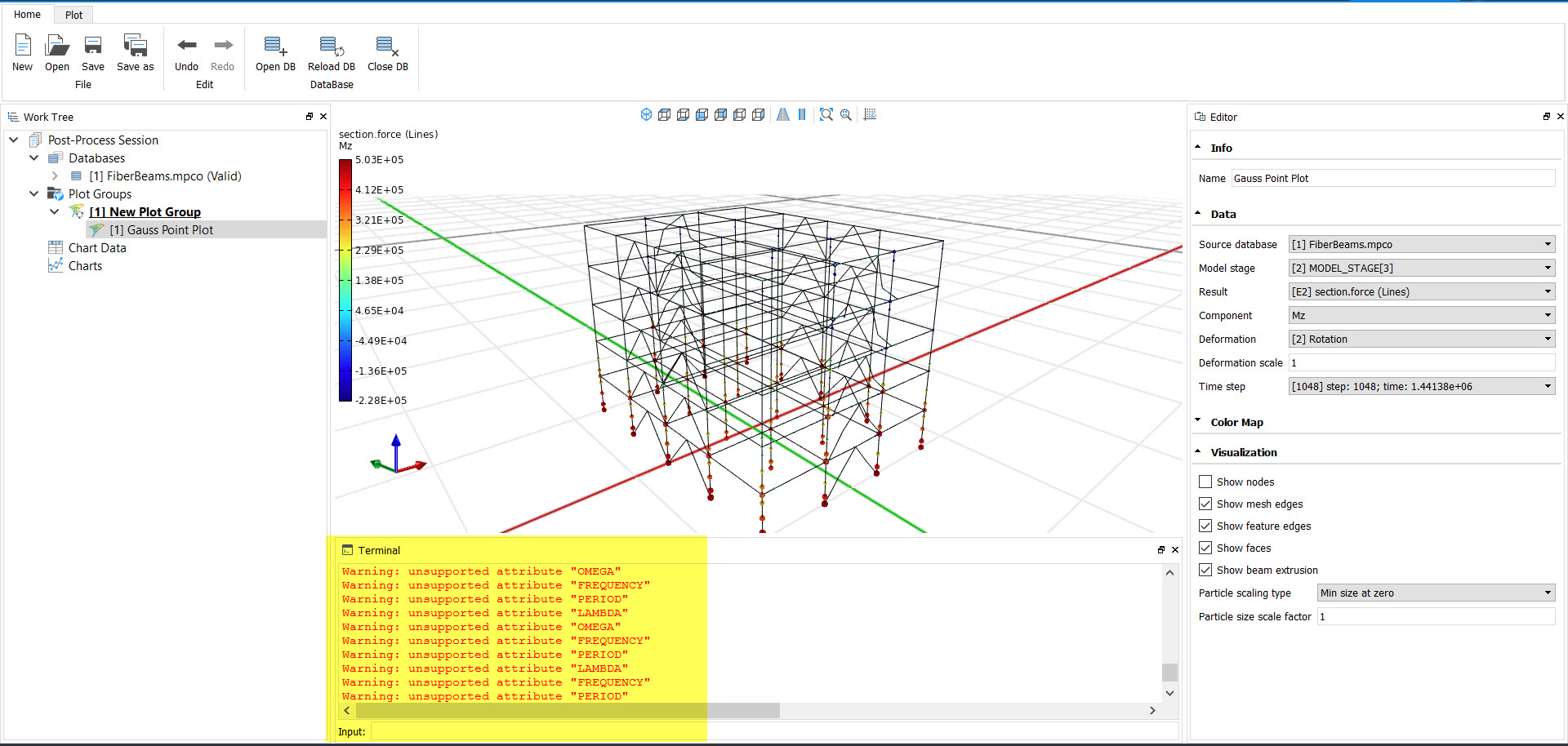

Now I run the TCL code and it creates a mpco file which is about 1.7(GB),
then I open it in the Post Processor section with "OpenDB" command,
after that I get some warnings, for example:"" Warning: unsupported attribute "LAMBDA""
I can see the plots for Deformed shape and Gauss point and ... and they seem reasonable,
but I don't know if I'm doing right, because of the warnings.

Dear Ali,
Don't warry about those warnings... You did an "eigen" analysis and requested the "modesOfVibration" output from "mpco" recorder. Now the "mpco" recorders also saves in the .mpco database the eigenvalues (and all derived quantities, OMEGA, FREQ PERIOD...) for each eigenmode.
The warning is simply due to the fact that the STKO post-processor does know how to treat those information yet:
we are still deciding where to put those infromation :lol: , probably we will put them in a table on the editor panel on the right, if you select the "modesOfVribration" result in the plot.

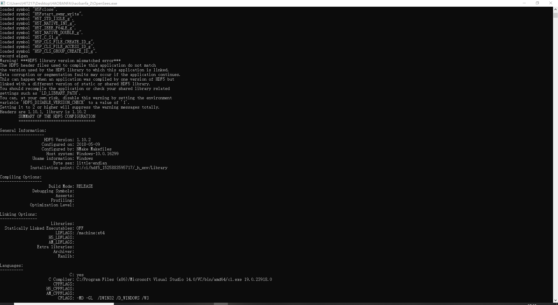

Yulu Liu
Posts: 22
Joined: Fri Nov 15, 2019 6:31 am
Re: Importing from tcl
Post by Yulu Liu » Tue Dec 24, 2019 9:19 am
Oh, I see.
The error is shown as the attached photo.
