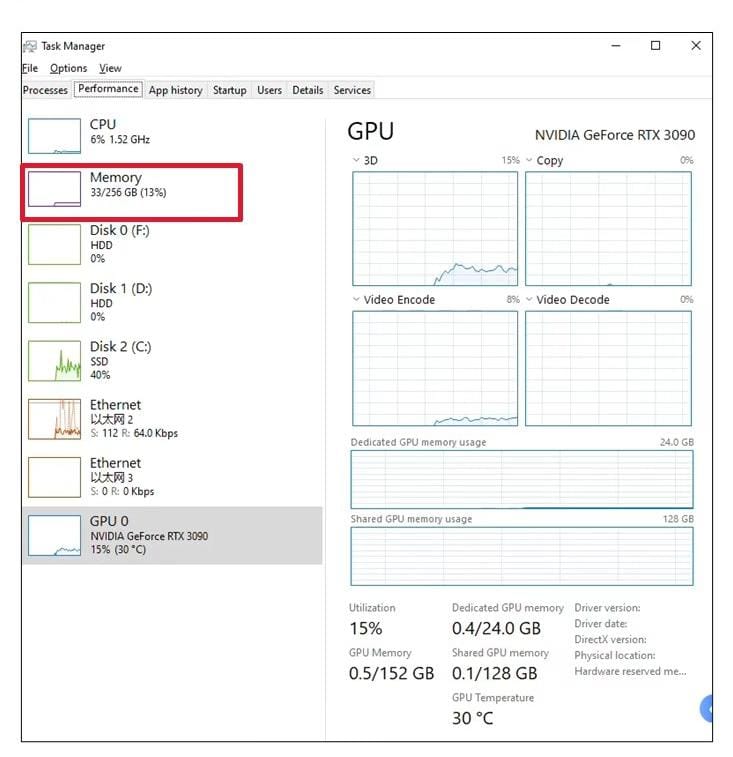

1. Hardware Setup:
I am using a desktop workstation equipped with an NVIDIA GeForce RTX 3090 (24 GB VRAM) and 256 GB System RAM.

Thank you for your reply.
Regarding your questions:
1. Hardware Setup:

- PC_ScreenShot.jpeg (52.93 KiB) Viewed 382 times
