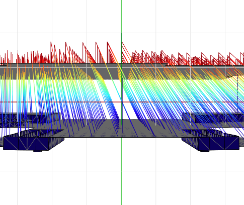

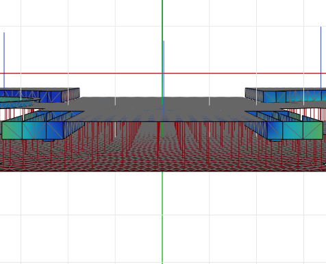

I initially performed the Eigenfrequency, Gravity, and Time-History analyses individually – all three produced plausible and consistent results. Notably, in the standalone Time-History Analysis, only the Lower Raft and the columns moved as expected, while the Upper Raft remained unaffected. see images Time History_1 and Time History_0.

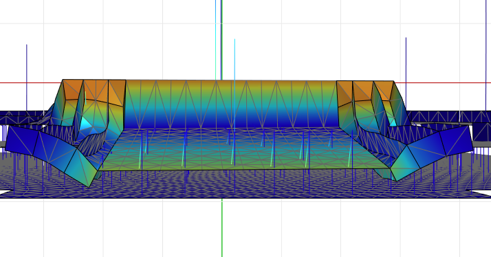

• Regardless of whether Stage 1 or Stage 2 is selected, the model only deforms in the middle region. Furthermore, the Upper Raft now shows deformation, which was not the case in the individual Time-History Analysis.
This behavior may indicate an incorrect load transfer, an inconsistent stage definition, or a constraint issue introduced during the combination of the two analyses. see image Gravity + TH.
