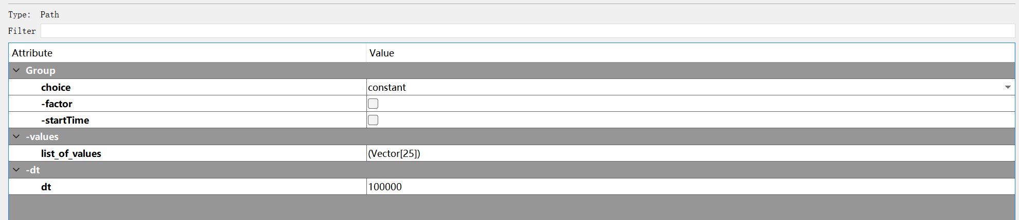

Dear stko team, I am currently applying loads via Faceforce and performing analysis. Could you please explain the relationship between the duration of time-series load application and the duration of the computational analysis?
Re: Apply load through Faceforce
Post by STKO Team » Fri Jan 23, 2026 8:58 am
It's pretty simple:
t = current time
lambda = timerSeries(t): the time is passes to the time series function, and the result is the load multiplier
Force = referenceForce * lambda, where reference force is what you input in the condition
