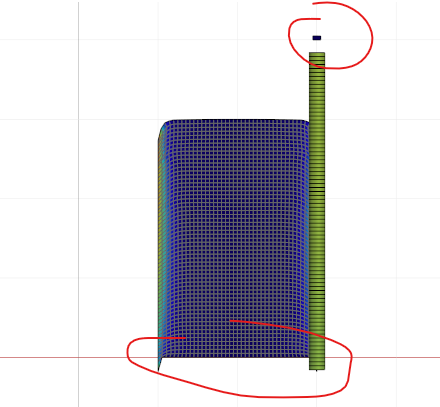

Look at the output:
when starting the dynamic analysis, the column is falling down.
This happens because you remove the SP constraints at the sides (which probably also contains the bottom of the column)
