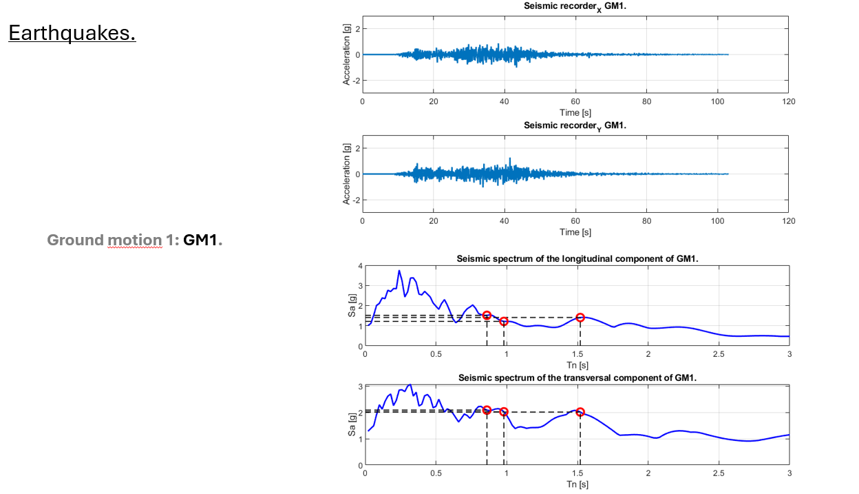

I want to ask about a convergency issue that I am dealing in a confined masonry structure subjected to acceleration recording in the X and Y directions. In the document CM Building that I attach you can find this STKO model with the planes of the structure which were the used information to model. I used ASDConcrete3D for the masonry panel, and the RC columns and beams, while ElasticMembranePlateSection was used for the slabs. The element used was ASDShellQ4. For the tensile and compressive fracture energies of the masonry panel I used Gc = 15 + 0.43 fc - 0.0036 fc^2 and Gt = 0.025 (2 ft)^0.7, which were the expressions that worked better in a previous calibration process that I carried out in a set of 2D walls subjeted to cyclic displacement. The registers used are attached below in the image called Registers. Previously, a modal analysis of the structure was carried out, with the results attached in the Modal.zip document.

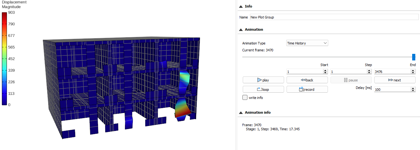

The main problem that I am dealing with in the seismic analysis is the non-convergency of the model due to the concentrations of deformations in some parts of the structure as you can see in the image called Non-Convergency that I had attached. I tried to solve that by generating a TCL script which use differents algorithms, but I couldn't pass this convergency issue.
I wanted to know if you can check my model and see if something related with the modelling or the choosen materials is generating the issue. I was thinking that the issue is a numerical one, but simply it could be maybe the collapse of these walls as well.
