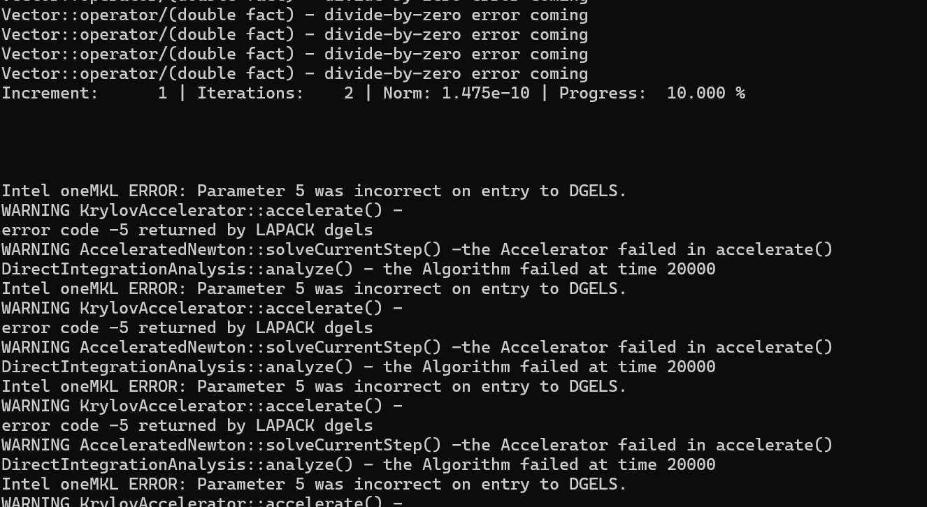

Hello, I am encountering the following error during calculation after executing `updateMaterialStage -material 2-stage 1` when using PM4sand material and SSPquadUP units. I am unable to resolve it and urgently require your assistance. Many thanks in advance!
Re: PM4sand
Post by STKO Team » Wed Sep 17, 2025 8:58 am
As you can see from the error, something is trying a division by 0.
Try to use an Elastic material instead of the PM4Sand. If the error disappers, then it means it has something to do with the PM4Sand. Probably some wrong parameters

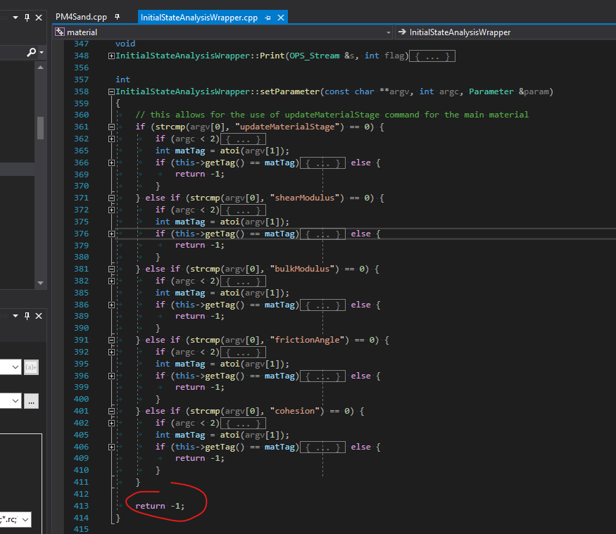

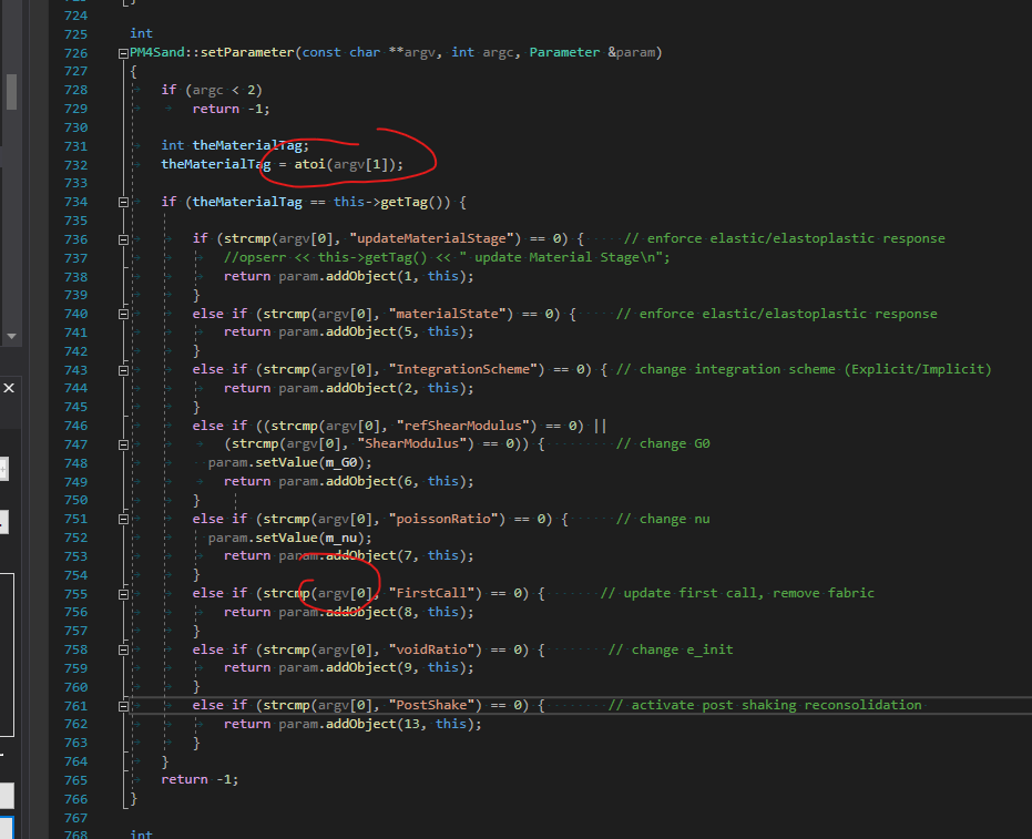

There were 2 issues:
  • You forgot to put the tag of your PM4Sand material after the FirstCall argument in the setParameter command. The PM4Sand only processes the first argument if the second argument is equal to its tag:
  • Now you cannot use the initialStateAnalysisWrapper.
    Who wrote that class only allowed a few parameters to be passed to the wrapped material:
    Therefore, your call to update the FirstCall parameter was not called
