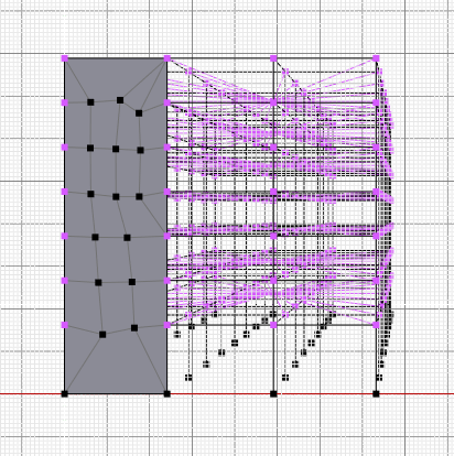

Hello STKO team,
I am working on converting a lumped plasticity frame model to a frame with MVLEM walls to represent a retrofit design of an existing structure. As you can see from the screenshot, I'm having issues with my mesh. I've watched the lectures on meshing and on using the MVLEM to try and troubleshoot. I've applied mesh conditions of structured, quad, and linear, but the mesh still does not look quite right, and of course, when I go to write my input file, I get the dreaded error: "invalid type of element or number of nodes" which indicates that something is wrong with the mesh. I would be super grateful if you can help me diagnose the issue with the mesh.
I would also greatly appreciate it if you can assist me by checking the SFI-MVLEM properties I've assigned since this is my first time using the MVLEM.
Thank you!
Katharine Rhoades
Thank you!
Katharine Rhoades

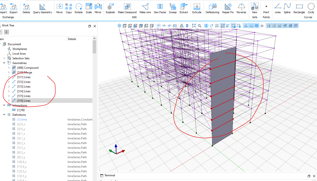

In order to have a quad-structured mesh, your geometry should be made of 4-sided surfaces.
Just create N lines like this, and merge:

Ohhh! Ok, that worked great! If I'm understanding correctly, it's because when the beam nodes connecting to the sides of the face, the meshing algorithm needs the additional lines to make the faces rectangular between the vertices, right?
