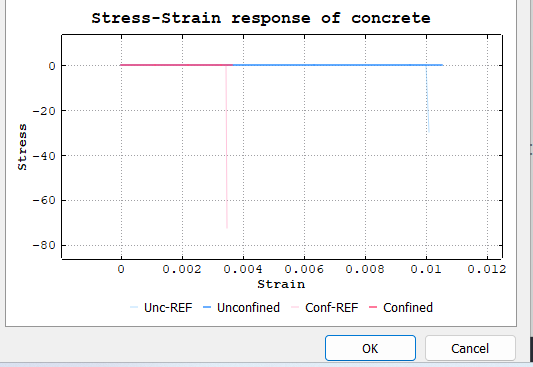

I am working on a high rise building. I get a wrong stress strain response for confined concrete once I defined the RectangularFiberSection for the column. Can you help me with this issue? I have attached the file.

- Stress strain response
- Screenshot 2025-06-21 113247.png (14.57 KiB) Viewed 2198 times

Re: stress-strain response of confined Concrete issue
Now the error is different: you are using positive values for concrete strain and negative values for stresses. While OpenSees now converts all of them to negative values, the Automatic Confinement tool expects those values to be ALL NEGATIVE. Just make them negativeI have already replaced those files. However the same error is occuring. Also this error is occuring when I run the model.
