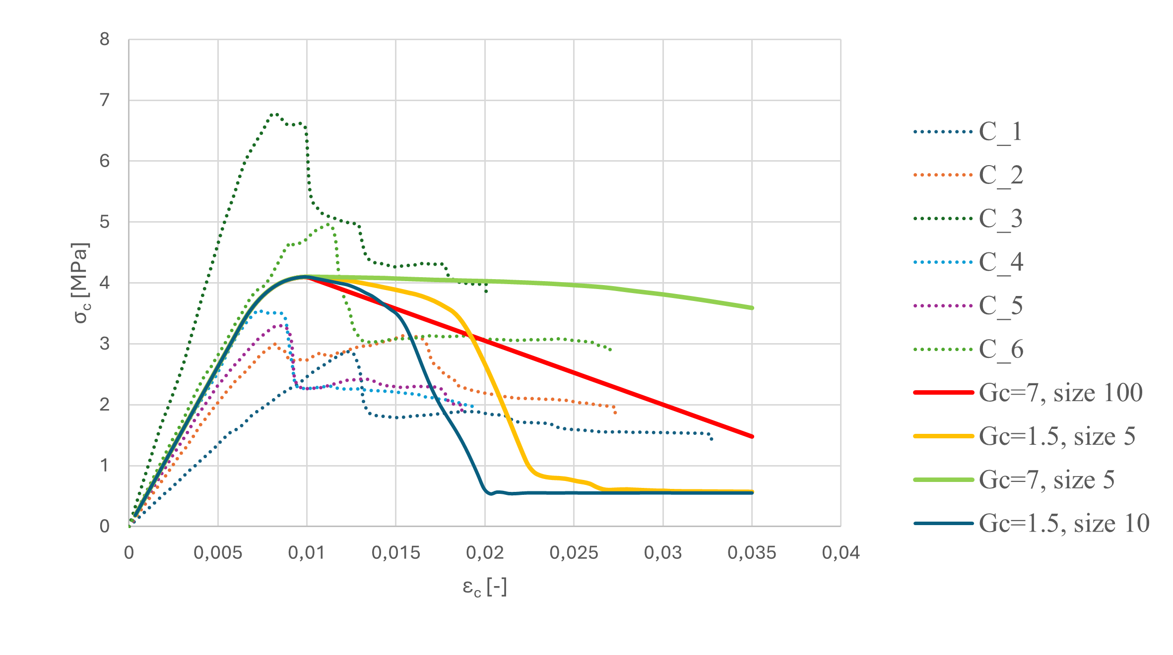

So I don't understand why changing the mesh size the final result changes. I enclose a graph in which the dotted lines are my experimental results and the solid lines several attempts at numerical tests.
The curves are named to indicate both the fracture energy value in N/mm and the mesh size.
I don't think it's a problem with the model because I've tried it with others that work and the material seems mesh dependent.

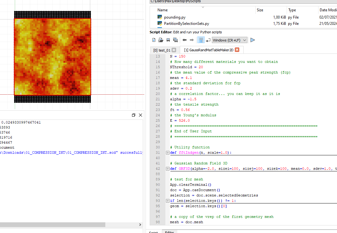

The auto regularization is working, however when you are trying to simulate a state of almost uniform strain (in your case uniaxial compression) the model "doesn't know" where to localize. So the damage will spread over a large area before some round-off error occurs, leading to the localized solution where the regularization works (in this cases using a smaller time step may help to a certain extent):
You can add some imperfections to verify this point:
GaussRandMatTableMaker2D.zip
(2.93 KiB) Downloaded 102 times
random imperfection generator.png (99.12 KiB) Viewed 2611 times

Thank you for your availability and response. Using the randomiser material wrapper the model seems more stable and the solution more accurate.
