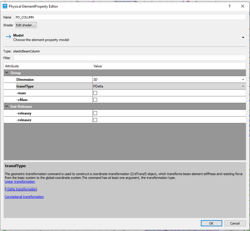

I have a question regarding the p-delta transformation. I checked with and without p - delta transformation but the push over Q-D curve was identical and does not appear to be working.

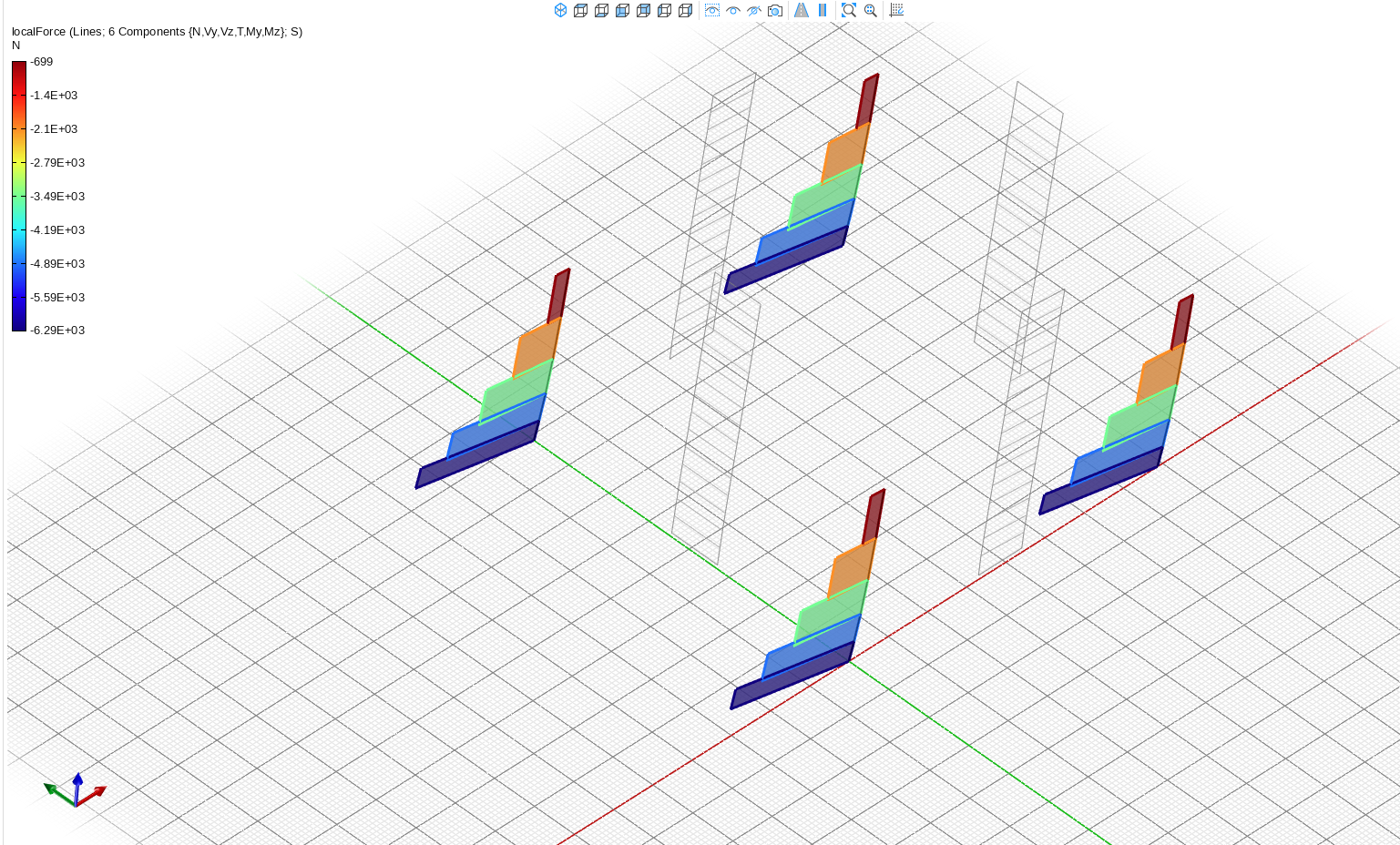

I assigned entire building weight divided by 4 (for now to see the maximum effect)for the corner posts to model PD leaning columns as below(axial load).
below is stko parameter.

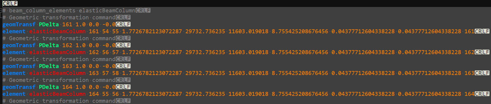

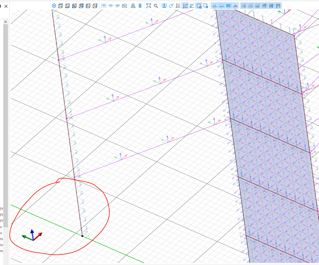

Below snip shows local axis. local blue > z is orientating global x +. and TCL appears to be correct.
Not sure why STKO input -0.0 for z, however.
Not important, the Z axis is computed as cross(X,Y).

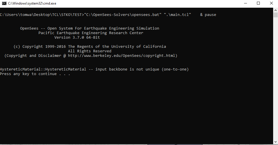

Can you please advise what I am doing wrong ? Your input would be appreciated.
If you refer to the error in the last image, there's an error in how you input the points in the backbone (see the error message)

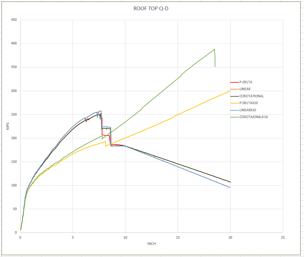

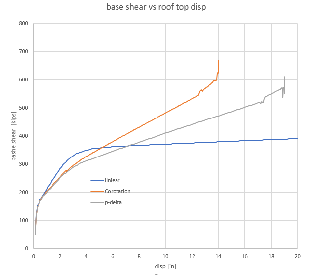

Sorry, last snip was accidentally posted & irrelevant. I increased the p -delta leaning column load x 10 times and started to see the difference. Below is what I got.
I would expect corotation & p-delta should go below the linear. Up to certain displacement is as expected but beyond around 5 inches the p -delta & corotation go above the linear, which is unusual to me.
Do you know what is causing this ? This is purely changing the beam-col element transformation, from Linear > p -delta > corotation.
Re: P delta transformation
Post by STKO Team » Mon Mar 17, 2025 8:56 am
Can you share your model? it's difficult to tell.
It seems like some elements with nonlinear kinematics are going in tension (stineffened due to large displacement)

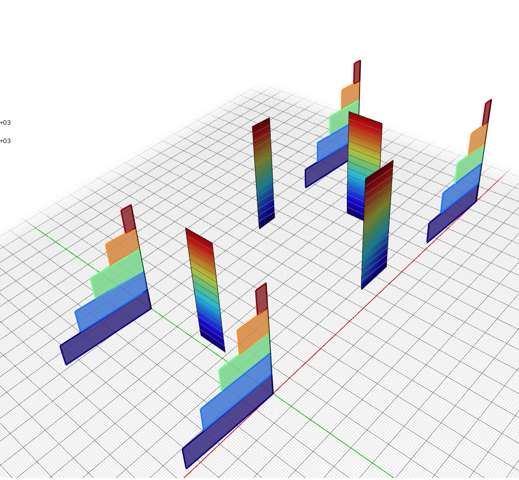

Further to my previous query, I still find something funny in my model. I checked p-delta, linear and corotational for, normal conditions and x10 exaggerated to see the p-delta sensitivity as previous.
1. I still have p-delta effect initially smaller than not considering it but in the end ramping up significantly. I have increased column load by 10.
2. I am aware that p delta leaning columns are squashed significantly. My understanding is that these are connected with rigid diaphragms in x and y direction but free to move z directions. Will the p-delta transformation effect be effective from the deflected shape under gravity loading in OpenSees ? In my exaggerated x10 load condition, the column is squashed 2m at the top. I can easily specify larger section, but have been avoiding it try not to attract moment between rigid diaphragms. I am pushing to 20 inches at roof COM, which is only 3.3 % and the column axial load is still under compression.

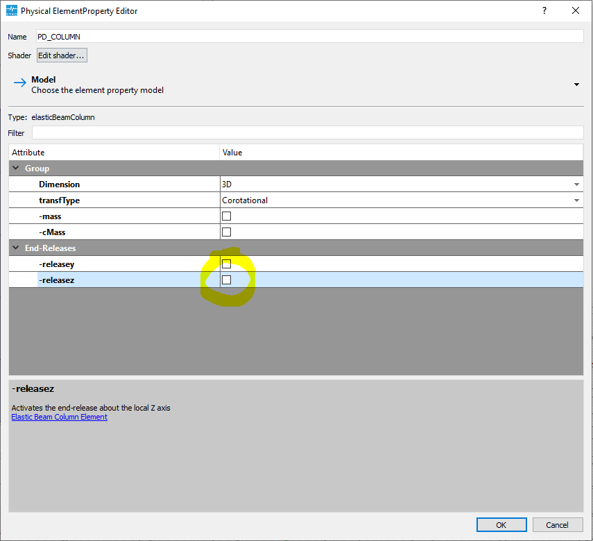

3. Ideally I want to have these p-delta columns pin connected, but whatever way I tried to pin them via below(high lighted in yellow), the model does not appear to run. I have been modifying the flexural stiffness modifier to really small number so that significant moment will not be attracted. Is there a clean way of having full pin connection to the diaphragm ?
The model can be downloaded from below.
Post by STKO Team » Wed May 28, 2025 11:54 am
Regarding the issue of making leaning columns fully released in rotation about local y and z axes
If you release rotational degrees of freedom (DOFs) at both the I and J nodes, the shared node between two elements will exhibit a singularity in its rotational DOFs.
To address this:
  • Ensure all columns have a consistent local X-axis direction (e.g., all pointing along +Z). This ensures that the I-node is always at the bottom and the J-node at the top of each column.
  • Release only Ry and Rz at the I-node. This prevents moment transfer between adjacent columns while avoiding singularities, since the node between two columns derives stiffness only from the J-node of the lower element.
  • Fix the global Ry and Rx rotations at the base node of the first column (as this node has no supporting element beneath it and would otherwise cause a singularity).
Anyway, this won't solve the issue of the curve going up.
I suspect the issue might be due to using corotational kinematics for the columns, but not for the walls (unfortunately, MVLEM_3D does not support nonlinear kinematics).
Can you try modeling the shear walls with shell elements (e.g., ASDShellQ4) that also use corotational kinematics?
Hint:
A strange thing you can notice in your current model is an increasing FX reaction in the leaning columns in the opposite direction of the walls' reactions. And they are zero when using Linear kinematics

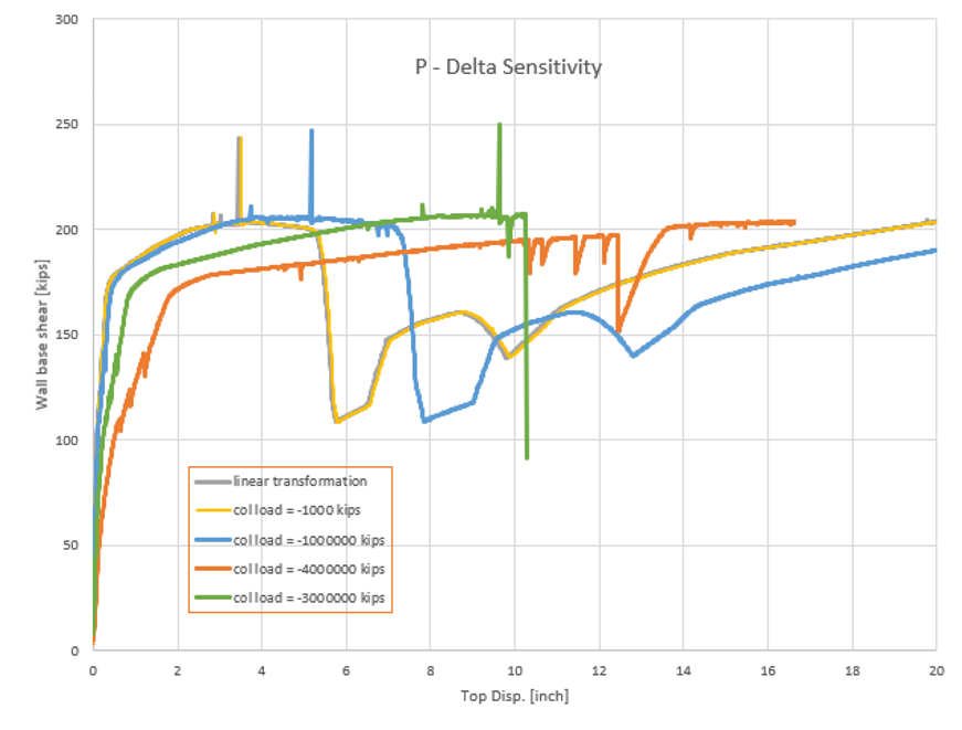

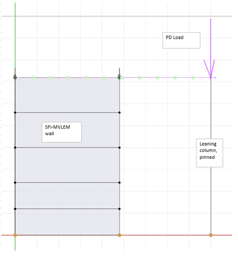

I checked with a simple model with PD leaning column and I get similar results as below.
I am aware that the displacement level and PD force I have here are huge trying to get QD descending curve that we often see in textbooks, but I could not get it with P-delta transformation.
I know many researchers include p-delta transformation for mainly moment frame structures, not sure if it is really working for wall structures. Within realistic drift level, p delta effect is not significant but when assessing the collapse, it becomes really important. I do not fully understand this but it is not true large deformation problems where node coordinates are updated at each load step ?
The example wall is 72 inch high and up to around 6% drift, the p - delta is indeed lower than not considering it. Majority of wall will collapse before that anyway.
I am interested if someone can demonstrate QD- descending curve with p-delta transformation with shear wall model in OpenSees.
Post by STKO Team » Tue Jun 03, 2025 8:25 am
Maybe the pdelta effect is not very visible within reasonable force-drift values in your example.
The only way you have to validate your approach is to either find some benchmark or experimental result in literature, or model everything with a corotational approach (p-delta is a subset of corotational) and check the results
