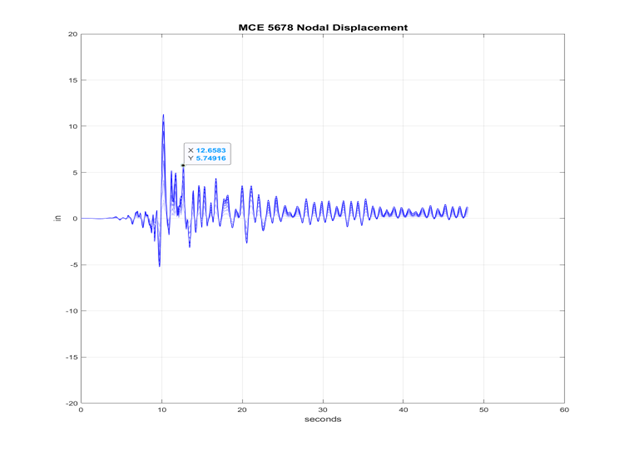

Thank you for the reply. I am a little confused. The nodal displacements come from a time-history analysis of seismic motion. This would be a classic time-history analysis, except that instead of a unique ground acceleration at each of 8000 steps, we have unique nodal displacements at each step. (See attached png file). So, using a multiplier like Lambda, I would need 14 different Lambdas (one for each displaced node), but also the Lambdas would change for each step...
Isn't there a way to load in a list of displacmenets for each node at each step? Or, if I am completely misunderstanding your response, could you please possibly include an example file for me to model from?
