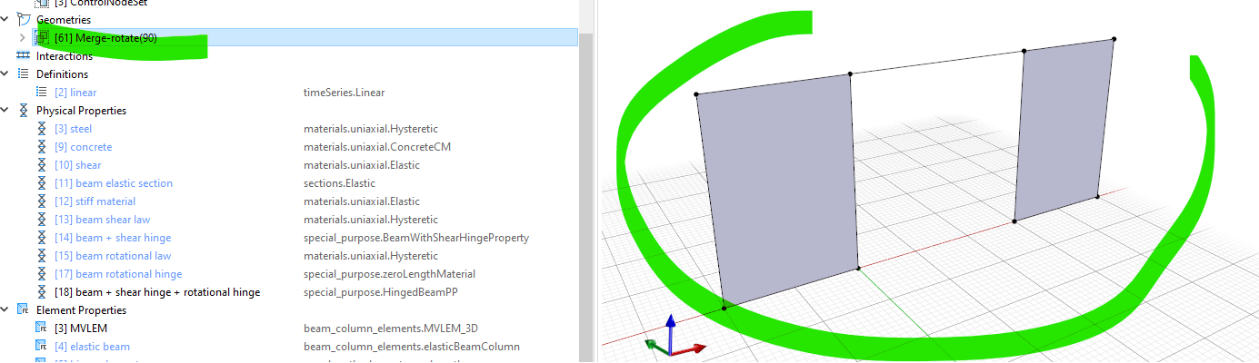

Actually in STKO we have 2 automation:
  • The HingedBeam element, which automatically places zero-length hinges at both ends of an Edge. it automatically detaches the Edge from the 2 end-nodes and places zero length at the 2 ends
  • The BeamWithShearHinge element, which automatically places a zero-length hinge in the middle of an Edge. It automatically splits the Edge into 2 pieces and puts the hinge in the middle
In the current version of STKO you cannot use them together, so I made a quick change to use them together.
Here's a modified version of the HingedBeam:
HingedBeam.zip
(3.48 KiB) Downloaded 290 times
You can extract it and place it in C:\Program Files\STKO\external_solvers\opensees\element_properties\special_purpose, replacing the existing one. it will be available for everyone in the next STKO version
And here is a simple example that shows you how to use it with MVLEM-3D:
MVLEM_CBEAm.zip
(139.62 KiB) Downloaded 313 times

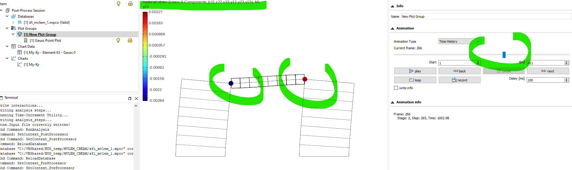

As you can see you have a simple attached geometry (as if the beam were continuous and attached to the walls):
In the first stage you will see the 2 rotational hinges yielding, but still in strain hardening. So both moment and shear grow together:
In the second stage, since the shear strength in this example is smaller, you will see a shear failure (and subsequently an unloading in moment-rotation to keep equilibrium with shear-softening):
NOTES:
The hinges (rotational and shear) are actually zero-length elements, so you can see their results asking for material.strain and material.stress in the MPCORecorder.
Then in the Post Processor you will see a material.strain/stress with 2 components for the shear-hinges (Vy, Vz) and a material.strain/stress with 6 components for the end-hinges (P, Vy, Mz, Tx, My, Mz).
Note that in these automations, the zero-length have automatically the same local axes of the parent beam element!

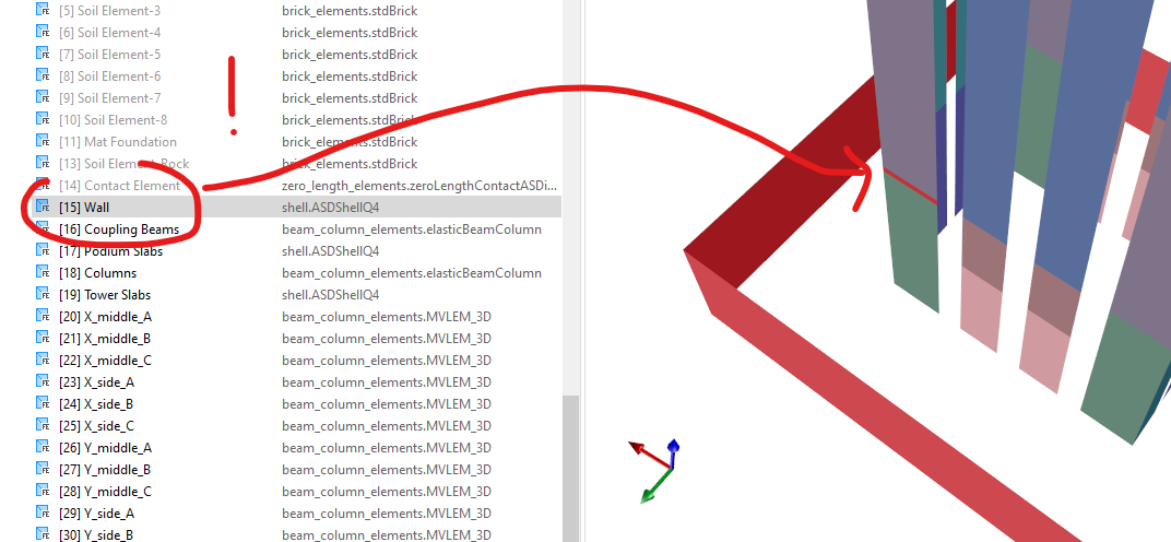

1) regarding MVLEM elements: currently they have assigned Physical Properties W_36, W_34, etc. (all except W_30 which is basement wall and it should be elastic). However, this doesnt make sense since they are MVLEM elements. When I remove mentioned Physical Properties, the model reports the error that something is not defined/assigned (it's not very clear).
Fixed like this:

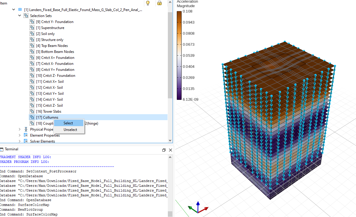

  1. Look at the complete Traceback of the error -> The error comes from the ASDShellQ4 Element property, therefore you probably assigned a shell element to what should have been a MVLEM
  2. Isolate the portion of the geometry with MVLEM and Shell(Wall) Element property to spot the issue (Select the target properties, then use the command "Show")
  3. Then I used the Label tool to understand what was the element property you wanted to use there

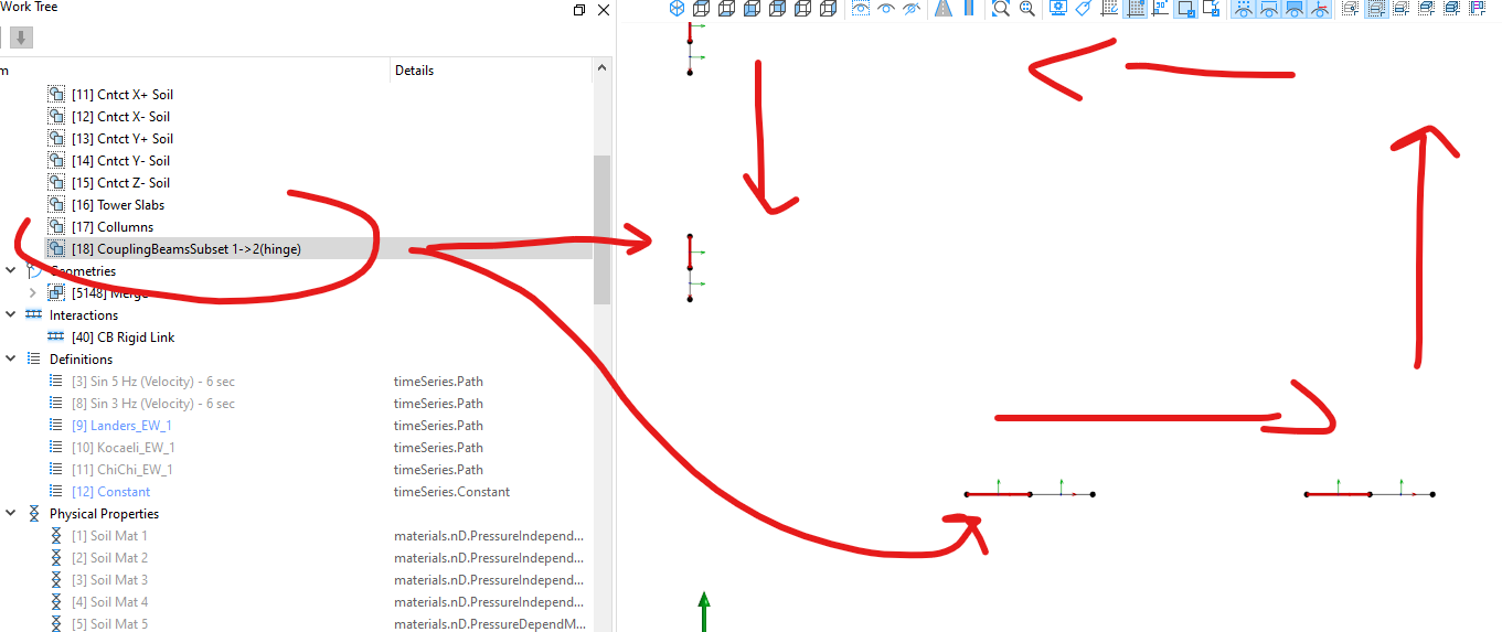

2) Regarding coupling beam: I have already created nodes in the middle and I am hoping to only assign a vertical shear spring using ZeroLenght elements. Is that possible? The approach you suggested is fine but I dont want to recreate the model. Do you think you can create only one shear hinge as an example in the attached model and I can take it from there? Uniaxial materials Pinching4 that start with CB (still unassigned) are intended for coupling beams.
If you don't want to change the geometry (next time it's easier if you use a unique edge, and then the BeamWithShearHinge), now you can use the HingedBeam, only on the first half of each edge, and using a hinge only on the node J (send node), which will correspond to the middle node:
  1. First I created a selection set with all the first-half parts of the edges of the coupling beams (luckily all the coupling beams were built with a counter - clockwise local X axis)
  2. Then I created a template physical property for the first half of the coupling beams. I used a elastic (E = 0) NULL material just to emphasize the shear hinge in the output, then you will change it with the Pinching you want.
    Note that you have to do it for each type of beam (for simplicity I used the same property on all the beams)
  3. This is what you get
Here's the file:

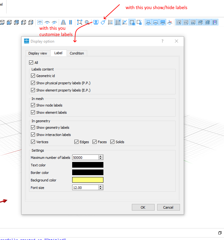

Where is this tool? I wished so many times that there is something that can tell you what is assigned to what. I didnt know it even exists. :D

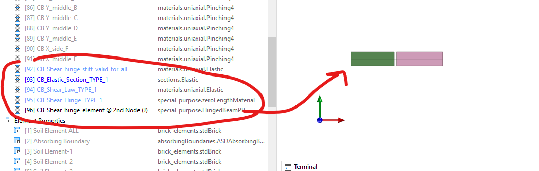

I would actually prefer to use only one edge and BeamWithShearHinge, but I got a bit confused about this. In my understanding, BeamWithShearHinge is a Property, correct? If that is the case, what element type should be assigned to the BeamWithShearHinge? I looked at your MVLEM example, but in that one you are combining HingedBeam and BeamWithShearHinge, and I couldnt really figure out how it works.
  • Physical Property
    • Define any physical property for a beam, for example a Section->Elastic (P1)
    • Define a uniaxial material for shear Vy (P2)
    • Define a uniaxial material for shear Vz (3P)
    • Create a special_purpose->Beam-Column->BeamWithShearHingeProperty
      • Beam Property = P1
      • Vy Material = P2
      • Vz Material = P3
      • K = a penalty > GA/L, for example GA/L*100
  • Element Property
  • Define a base element property compatible with the Physical property P1, for example beam_column_elements->elasticBeamColumn (E1)
  • Create a special_purpose->BeamWithShearHinge (E2)
    • Beam Element = E1
