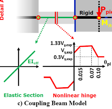

2) How would you go about modeling of coupling beams? Currently I have two elastic beams in my model with a node in the middle intended for a shear hinge. Do I just simply add a zero length element to the middle node? Any particular details I should pay attention to?

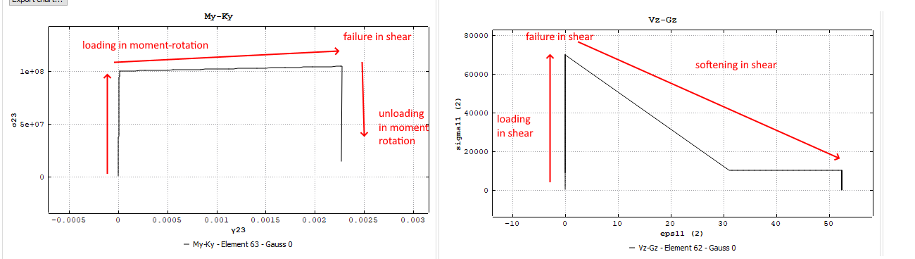

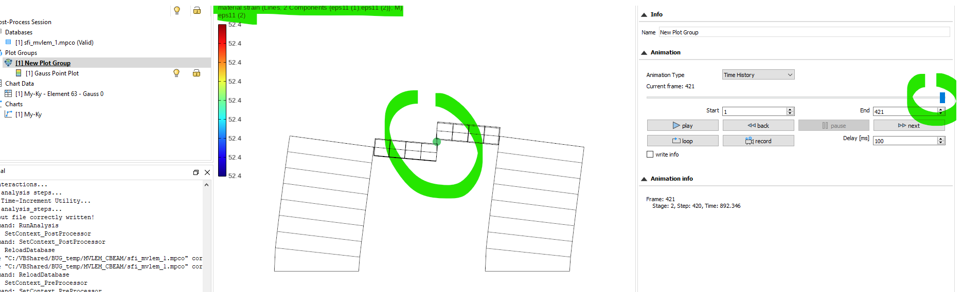

Actually in STKO we have 2 automation:
Here's a modified version of the HingedBeam: You can extract it and place it in C:\Program Files\STKO\external_solvers\opensees\element_properties\special_purpose, replacing the existing one. it will be available for everyone in the next STKO version
And here is a simple example that shows you how to use it with MVLEM-3D:
As you can see you have a simple attached geometry (as if the beam were continuous and attached to the walls):
In the first stage you will see the 2 rotational hinges yielding, but still in strain hardening. So both moment and shear grow together:
In the second stage, since the shear strength in this example is smaller, you will see a shear failure (and subsequently an unloading in moment-rotation to keep equilibrium with shear-softening):
NOTES:
The hinges (rotational and shear) are actually zero-length elements, so you can see their results asking for material.strain and material.stress in the MPCORecorder.
Then in the Post Processor you will see a material.strain/stress with 2 components for the shear-hinges (Vy, Vz) and a material.strain/stress with 6 components for the end-hinges (P, Vy, Mz, Tx, My, Mz).
Note that in these automations, the zero-length have automatically the same local axes of the parent beam element!
- The HingedBeam element, which automatically places zero-length hinges at both ends of an Edge. it automatically detaches the Edge from the 2 end-nodes and places zero length at the 2 ends
- The BeamWithShearHinge element, which automatically places a zero-length hinge in the middle of an Edge. It automatically splits the Edge into 2 pieces and puts the hinge in the middle

Please note that I do not need to use both shear and flexural hinges. I only want to use shear hinge in the middle of the beam. Please see the attached model. I would really appreciate if you can help me with two things:

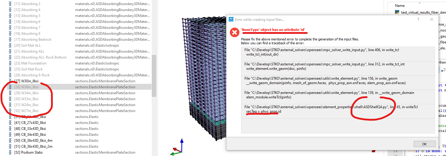

1) regarding MVLEM elements: currently they have assigned Physical Properties W_36, W_34, etc. (all except W_30 which is basement wall and it should be elastic). However, this doesnt make sense since they are MVLEM elements. When I remove mentioned Physical Properties, the model reports the error that something is not defined/assigned (it's not very clear).

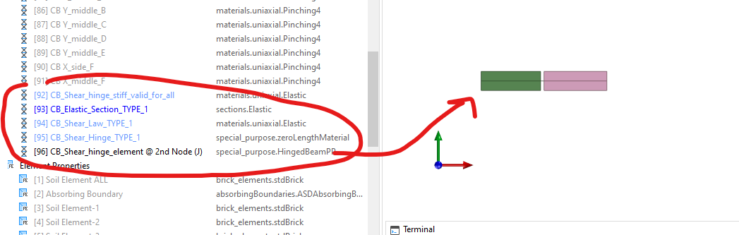

2) Regarding coupling beam: I have already created nodes in the middle and I am hoping to only assign a vertical shear spring using ZeroLenght elements. Is that possible? The approach you suggested is fine but I dont want to recreate the model. Do you think you can create only one shear hinge as an example in the attached model and I can take it from there? Uniaxial materials Pinching4 that start with CB (still unassigned) are intended for coupling beams.

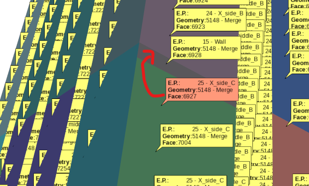

Fixed like this:1) regarding MVLEM elements: currently they have assigned Physical Properties W_36, W_34, etc. (all except W_30 which is basement wall and it should be elastic). However, this doesnt make sense since they are MVLEM elements. When I remove mentioned Physical Properties, the model reports the error that something is not defined/assigned (it's not very clear).
- Look at the complete Traceback of the error -> The error comes from the ASDShellQ4 Element property, therefore you probably assigned a shell element to what should have been a MVLEM
- Isolate the portion of the geometry with MVLEM and Shell(Wall) Element property to spot the issue (Select the target properties, then use the command "Show")
- Then I used the Label tool to understand what was the element property you wanted to use there
If you don't want to change the geometry (next time it's easier if you use a unique edge, and then the BeamWithShearHinge), now you can use the HingedBeam, only on the first half of each edge, and using a hinge only on the node J (send node), which will correspond to the middle node:
- First I created a selection set with all the first-half parts of the edges of the coupling beams (luckily all the coupling beams were built with a counter - clockwise local X axis)
- Then I created a template physical property for the first half of the coupling beams. I used a elastic (E = 0) NULL material just to emphasize the shear hinge in the output, then you will change it with the Pinching you want.
Note that you have to do it for each type of beam (for simplicity I used the same property on all the beams) - This is what you get

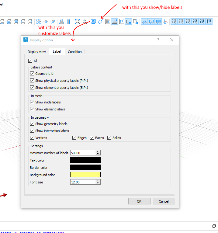

Where is this tool? I wished so many times that there is something that can tell you what is assigned to what. I didnt know it even exists.Then I used the Label tool to understand what was the element property you wanted to use there

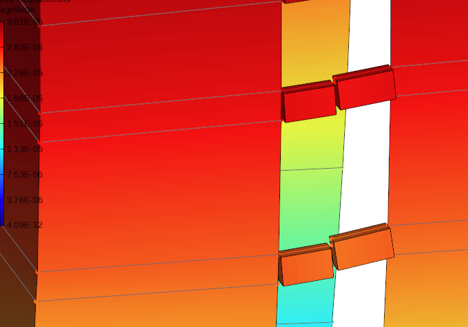

I would actually prefer to use only one edge and BeamWithShearHinge, but I got a bit confused about this. In my understanding, BeamWithShearHinge is a Property, correct? If that is the case, what element type should be assigned to the BeamWithShearHinge? I looked at your MVLEM example, but in that one you are combining HingedBeam and BeamWithShearHinge, and I couldnt really figure out how it works.If you don't want to change the geometry (next time it's easier if you use a unique edge, and then the BeamWithShearHinge)
- Physical Property
- Define any physical property for a beam, for example a Section->Elastic (P1)
- Define a uniaxial material for shear Vy (P2)
- Define a uniaxial material for shear Vz (3P)
- Create a special_purpose->Beam-Column->BeamWithShearHingeProperty
- Beam Property = P1
- Vy Material = P2
- Vz Material = P3
- K = a penalty > GA/L, for example GA/L*100
- Element Property
- Define a base element property compatible with the Physical property P1, for example beam_column_elements->elasticBeamColumn (E1)
- Create a special_purpose->BeamWithShearHinge (E2)
- Beam Element = E1

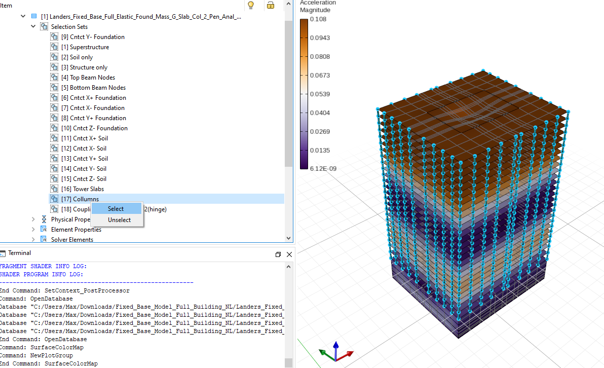

Thank you for detailed response. I have re-did the model with BeamWShearHinge property (it is much cleaner that way) and I assigned actual properties of all coupling beams (model is attached). However, unfortunately, the model is not converging at about 30% of the ground motion. I have tried several things such as using linear materials for coupling beams and changed a bit penalty parameter for BeamWShearHinge (10^9, 10^10, 10^12), but I couldn't fix the convergence issue. I am using Concrete02 and Steel02 materials for MVLEM_3D elements and Pinching4 materials for coupling beams. I have use this combination of materials and models on large building models and didnt have any convergence issues.
I have a few questions/requests if you dont mind:
1) Can you please give me some advice how can I figure out what is causing the convergence problems? Is there any tool in STKO that can say which element is the problem?
2) Can you please scan through the attached model and let me know if there any issues with it, particularly in terms of definition of nonlinear materials/elements?
3) Can you please tell me how can I implement an alternative nonlinear solution strategy that will be executed in case the analysis fails with the current nonlinear solution algorithm? For example, if analysis doesn't converge with current stiffness to switch to initial stiffness. This is possible in OpenSees with some coding, but I am not sure how to do that in STKO.

Here's a working file:
Anyway, most of the times I solve convergence issues just by using adaptive time step. The type of solver should be decided based on the type of problem you have.
- The analysis starts to have convergence issues at about 30% probably due to softening in some walls. It stops because you selected Fixed Time Step. I switched to Adaptive Time Step
- At this point It was converging thanks to the adaptive time step, but the convergence was very poor, so I stopped it to have a look at the results. It appeared that at about 30% of the analysis, the acceleration in one corner of a wall was blowing up to unreasonable values (1.2e4 m/s^2!!!!).
- So there was clearly something with the dynamic analysis. I noticed that you used the Tangent Stiffness in the Rayleigh Damping. I switched to Initial Stiffness and it runs fine now.
Why?
Making damping relative to the tangent stiffness is not a good choice. What happens when you have softening? Negative eigenvalues on the tangent stiffness, hence negative damping forces... Just think that, even though we call it "stiffness", the tangent matrix just contains numbers (components of the gradient of unbalance forces) that may not have any physical meaning.
Furthermore, damping is a way to include nonlinearities that we did not include via non-linear constitutive models, so it seems reasonable to make it relative only to the elastic stiffness
There is not such a tool in STKO. What I typically do is to look at the output and try to understand what is going on from the results.1) Can you please give me some advice how can I figure out what is causing the convergence problems? Is there any tool in STKO that can say which element is the problem?
It can be done using custom functions that can be called before and/or after the current analysis step is solved. It's a new feature that is not yet documented because we will do a webinar about it. But if you need it let us know, and we will try to explain it here.3) Can you please tell me how can I implement an alternative nonlinear solution strategy that will be executed in case the analysis fails with the current nonlinear solution algorithm? For example, if analysis doesn't converge with current stiffness to switch to initial stiffness. This is possible in OpenSees with some coding, but I am not sure how to do that in STKO.
