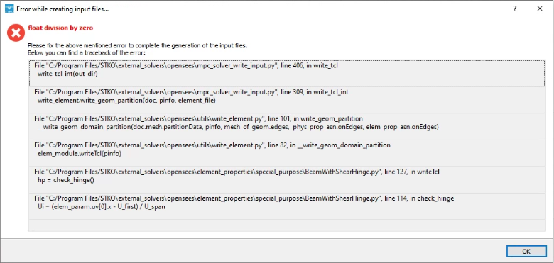

Thank you for your response. I did what you said and I received an error message below.
Please advise.
Please advise.
- Capture.PNG (190.35 KiB) Viewed 3460 times
I'm afraid there is a collapsed edge in your model. Otherwise, U_span is always > 0. Unless the 2 nodes of an edge coincide. Could you share your model? or send it here: [email protected]

Here we are! You found a bug that only happens when the BeamWithShearHinge is used on an Edge which is a boundary of a face (like in your example).
Instead, when the edge is free (like in a pure frame model) this bug did not appear.
Now, following the previous steps
