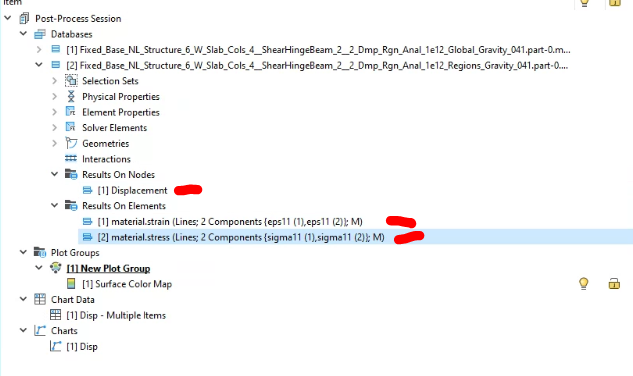

1) how do I access results marked with red in the screenshot?

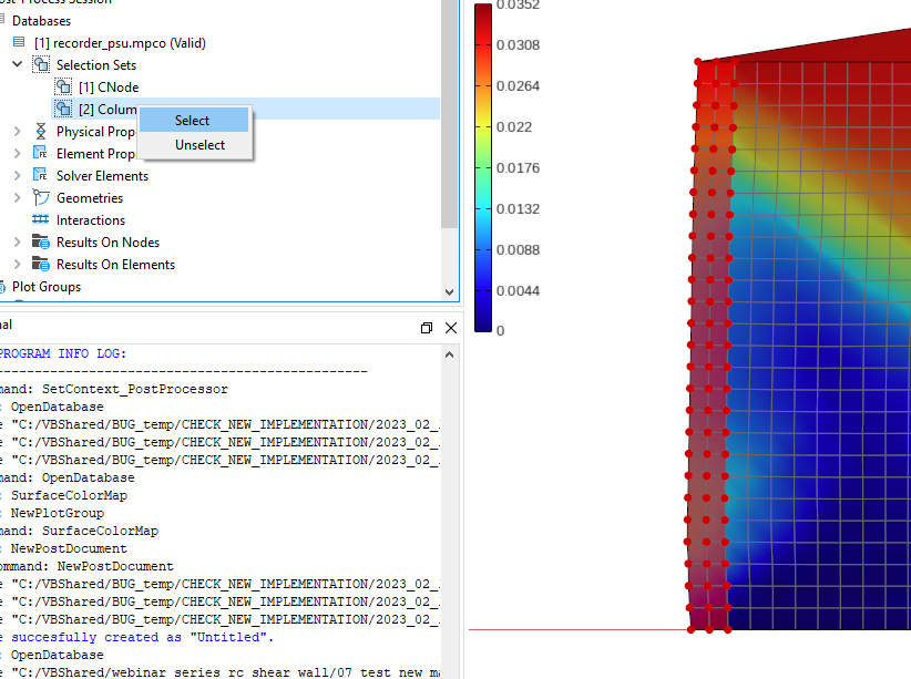

No, actually the example I sent you extracts the results you requested (all components) from all nodes or elements you selected.
For example, if you want to extract from a selection set, just select it, and then run the script:
