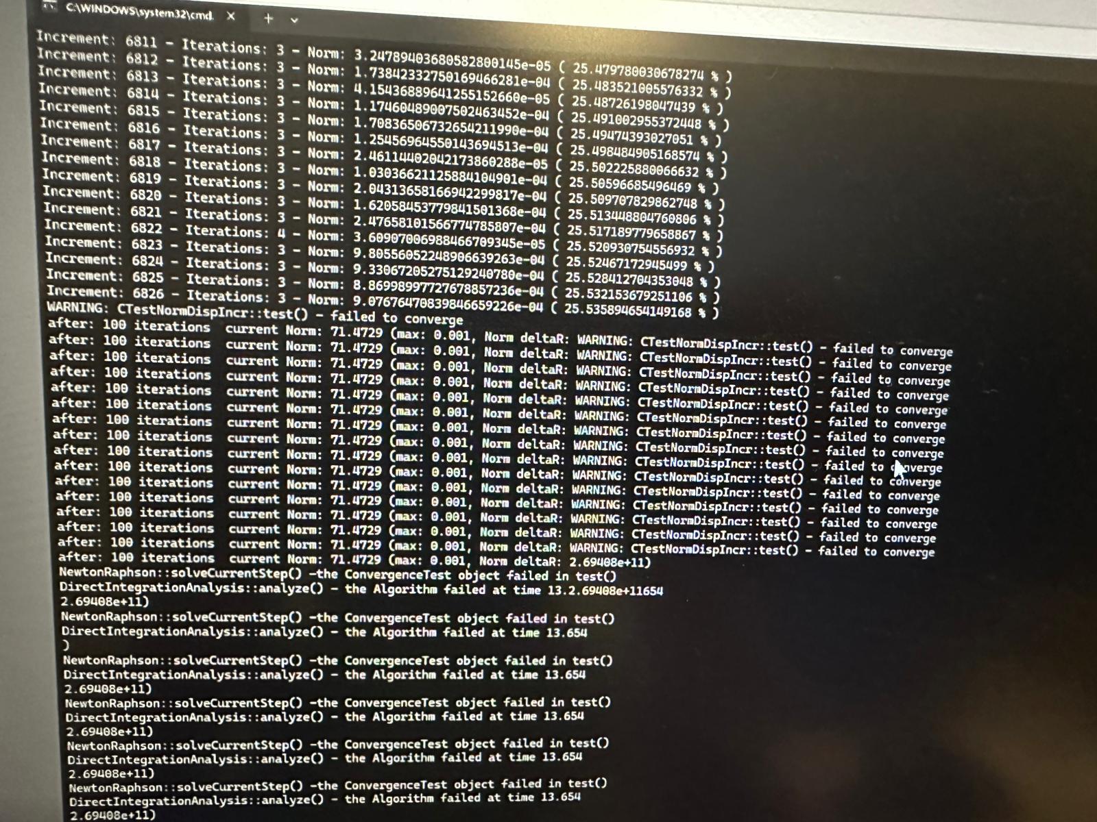

In order to mitigate the widespread local damage, I tried introducing elastic and rigid plates. At first glance, this seemed to improve the behavior. However, the analysis now stops at around 20–25% due to convergence problems. I already tried different solution algorithms (Newton, Newton with Line Search, Krylov-Newton with max dim 100), but without success: the analysis always stops at the same point.

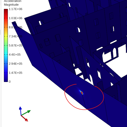

I am attaching the "Model_Withplates.scd" file with the added plates and the post-processing results at the step where the analysis fails (post-processing files are in the folder "Out_Sat"). After a certain number of steps, the structure again shows a non-global response, with localized damage and unrealistically high accelerations.

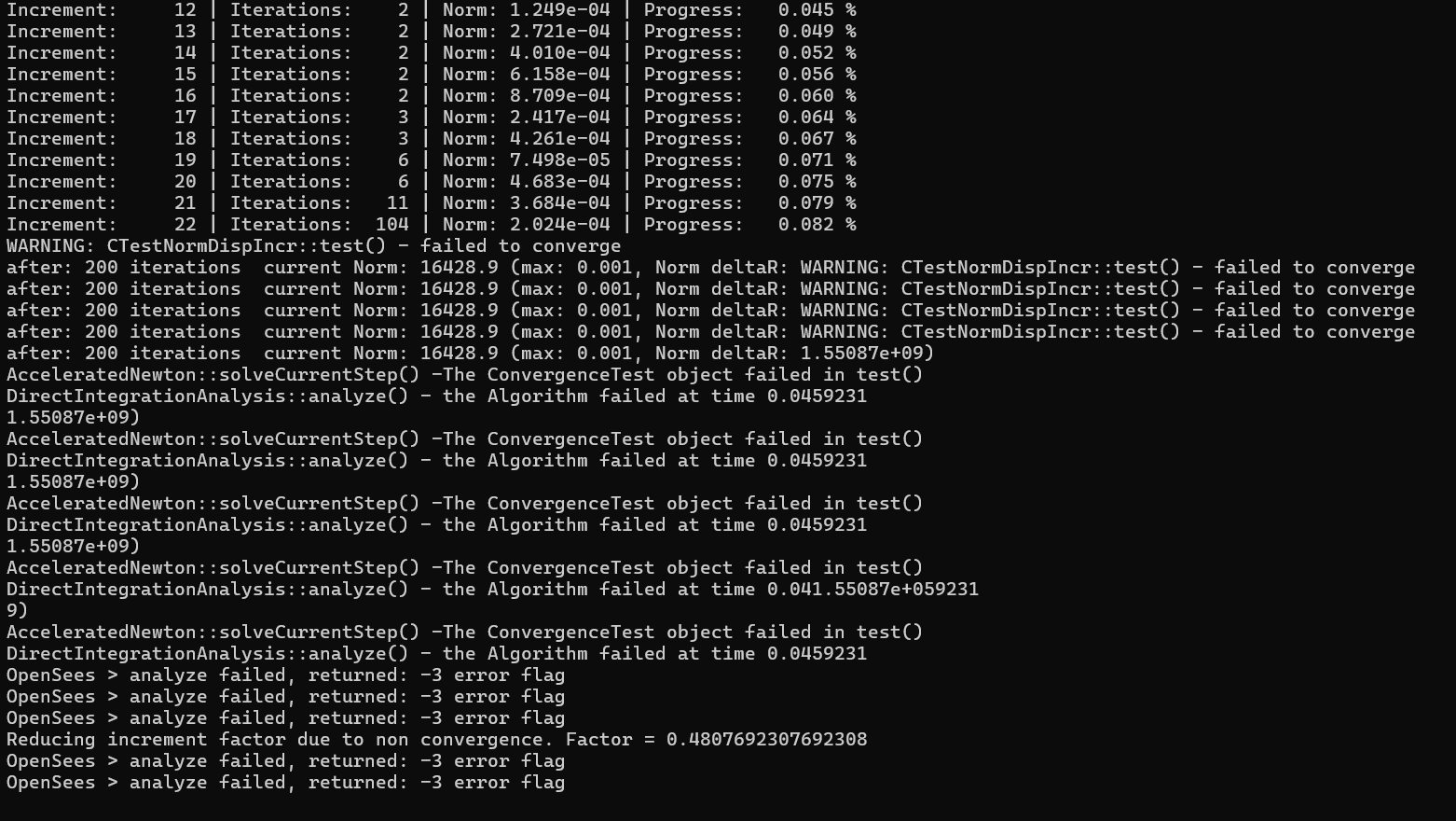

Thanks for pointing this out! Apologies for the confusion — the file I shared earlier was from some of my test runs. In my actual work I have already set up the analysis with Parallel RCM numberer and Mumps system. The issues I described (non-global response, convergence problems, etc.) are precisely the ones occurring in the parallel analysis with the correct settings.
I’m now attaching the correct file launched in parallel with 5 processors (but I experienced the same problem also when running with 16 processors), together with the post-processing outputs where the anomalous behavior appears.
I am also re-attaching the model with the added plates. This solution was already tested on 16 processors, and in that case the analysis stopped due to convergence issues after about 20–25% of the run.
Could you kindly help me understand where the problem might lie, or suggest possible solutions? Your support would be greatly appreciated.

When using a continuum (or shell) model, you cannot lump masses and forces at single nodes as you would in a frame model.
If you do so — especially with a fine mesh — you will experience stress singularities.
In your model, the vertex 1189 (of Geometry 1800) fails under gravity, which causes the dynamic analysis to diverge. This node has a total of -162650.94 N of concentrated node force acting on it in the vertical direction.
With a mesh size of approximately 500 mm, the applied force acts on roughly half of an element, i.e., over a length of 250 mm.
Given a thickness of 350 mm, the resisting area can be estimated as:
A = 250 mm × 350 mm = 87500 mm^2
If the peak compressive strength of the material is 1 MPa, the maximum resistant force at that section is:
Fmax = 1 MPa × 87500 mm^2 = 87500 N
which is less then the applied vertical force.
