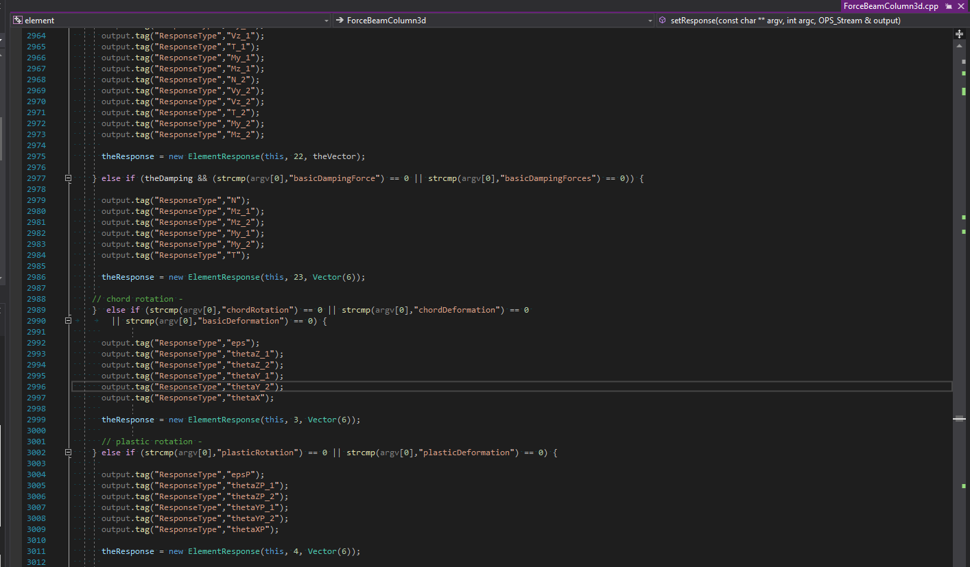

It depends on the element that you use, but most beam elements should support the "chordRotation" output.
FB Chord.png (114.87 KiB) Viewed 5508 times

okok, thanks a lot for the answer. Therefore, to do so, should i go to the custom element results in the analysisStep Editor inside the pre-processor window, right? I'm saying this since that chordRotation output is not mentioned in the built-in ones and i don't know otherwise how could i do.

Sure, in the MPCORecorder, go to "custom element results" and add the string you want.
We did this because in OpenSees, for element-based results, you may have potentially an infinite number of possible results.
Therefore we created built-in choices only for the most-commonly used ones.
