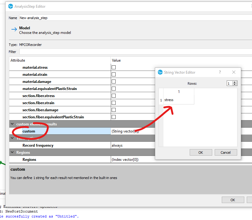

That's because the SSP brick elements do not support the "material" keyword before the "stress" keyword (they have only 1 integration point)
So you can simply use the custom results an input "stress" only:

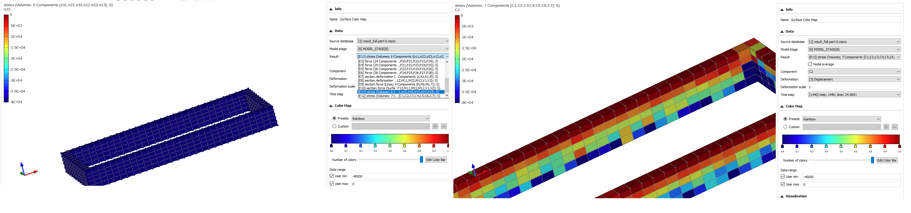

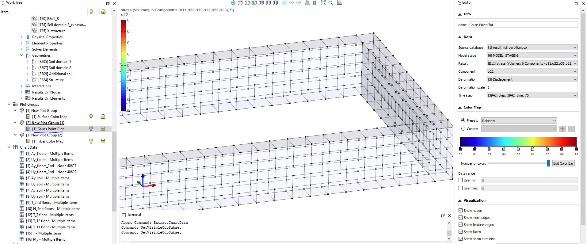

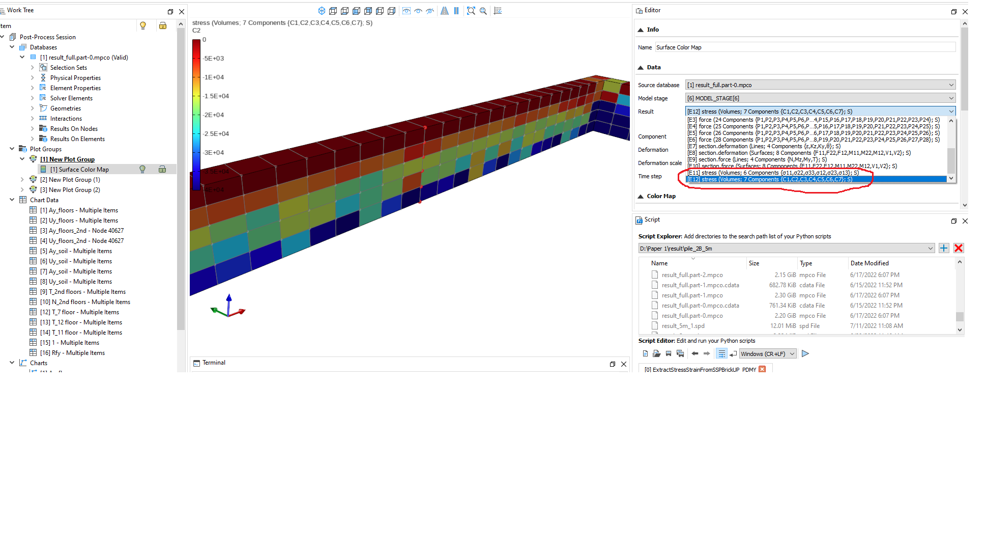

As you can see in Figure 1 which is surface color map, I can show volume stress (6 components, all values is 0) and volume stress (7 components). what is the difference between them? (as your suggestion, I added "stress" in custom element results of recorder to get stress of SSPBrickup element).
In figure 2 which is gauss point plot, I cannot see any gauss point in soil domain, and the volume stress (7 components) disappear, it has only volume stress (6 components).

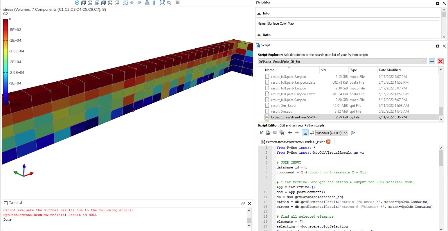

actually, I got this errors when running the code as shown in Figure 1
what is the problem?
There are 2 stress in the plot: Volume stress (6 components) and Volume stress (7 components) as in Figure 2.
I am trying to extract stresses from Volume stress (7 components), I dont know the difference between 2 types of volume stress but in Volume stress (6 components), all values are 0.
