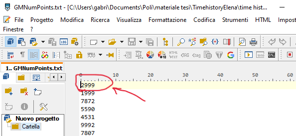

The number of steps for each seismic input is in " GMNumPoints.txt " file.
(for the first there are 2999 steps, the second 1999 steps and so on...)
In the output I should obtain a number of steps = number of steps of each seismic input, (that is 2999 steps for the first input, 1999 for the second and so on until the last seismic input), but it doesn't happen. I obtain less steps in the output than the number expected. I can't understand why.

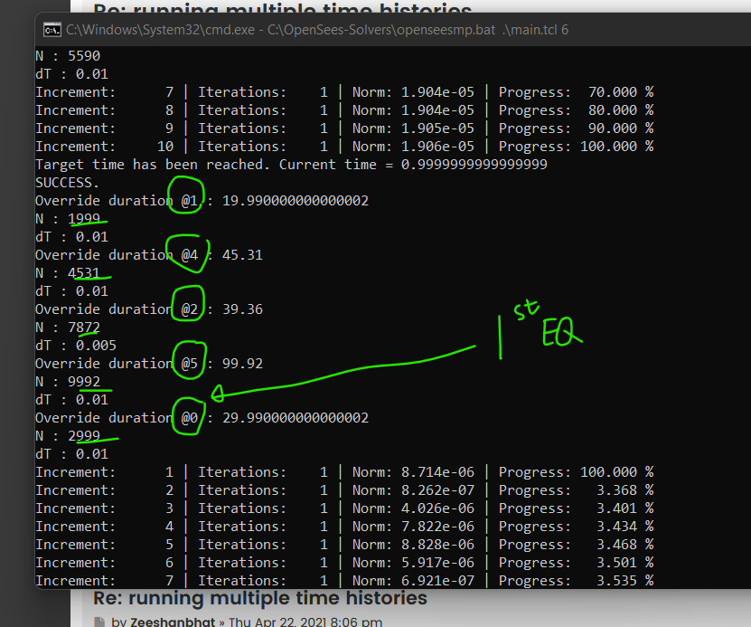

Re: running multiple time histories
Post by kesavapraba » Thu Mar 07, 2024 10:33 am
Hello, I understand your question clearly now. I did a parametrized analysis of your model using only six accelerograms, and it worked well. To identify which processor is handling each accelerogram, refer to the figure below. Please note that the order of information (no. of steps) displayed on the command prompt screen may be shuffled differently. Additionally, I included a monitor plot in parallel mode to validate the results - please find the attached model with the six records.

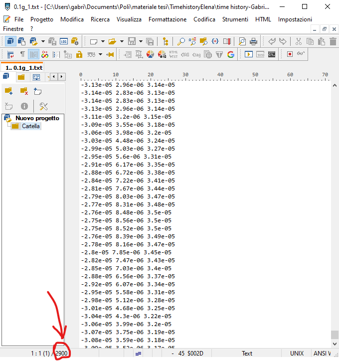

the issue is with the drifts in the output. I make an example just for the first seismic input, because the issue is the same for the others.
In the file " GMNumPoints.txt " there are 2999 lines , while in the corresponding drift file in output I obtain just 2900 lines, so 99 lines are missing.
I Attached the images in order to be clearer, meanwhile thanks for the support!
