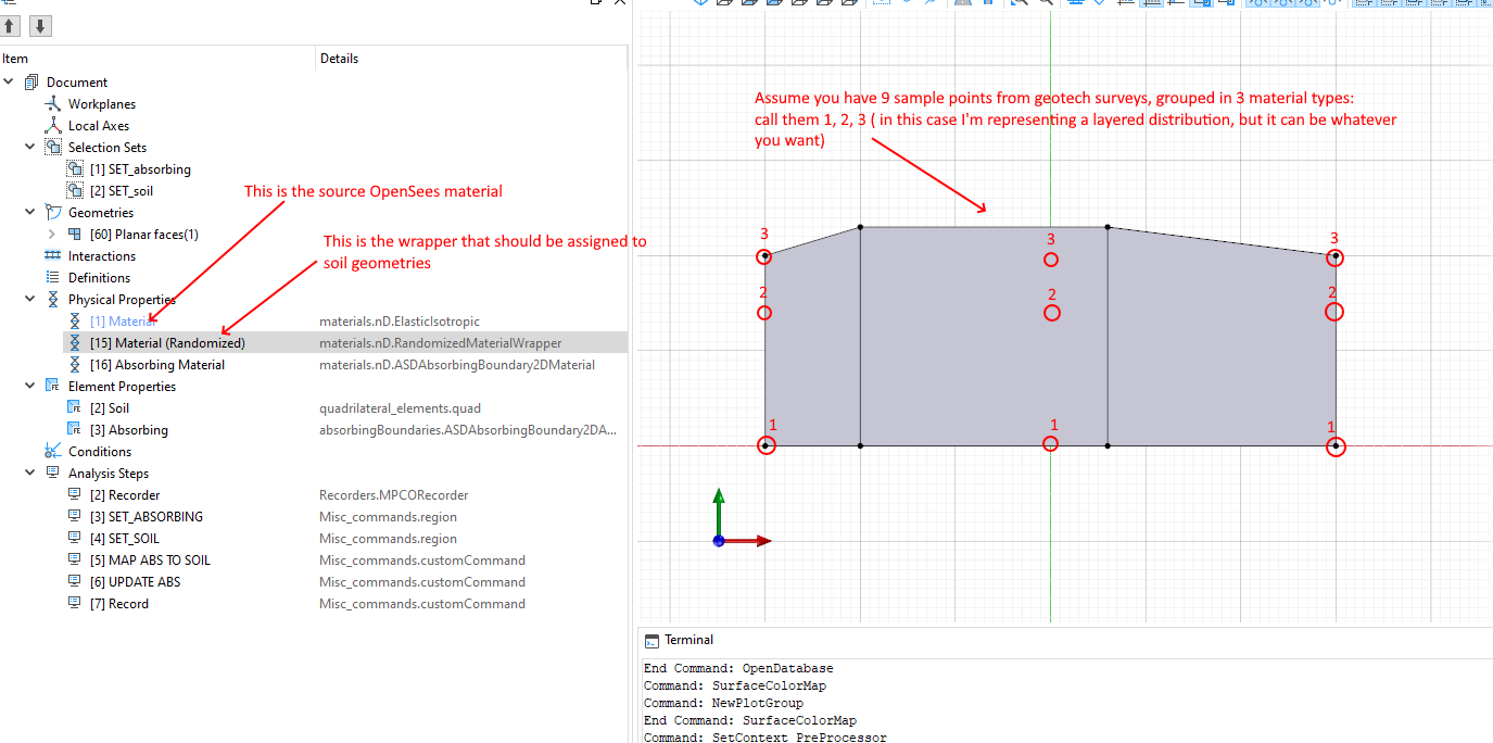

You can do it quite easily. We just developed a tool for this. But it's not yet documented so I will try to explain it here.

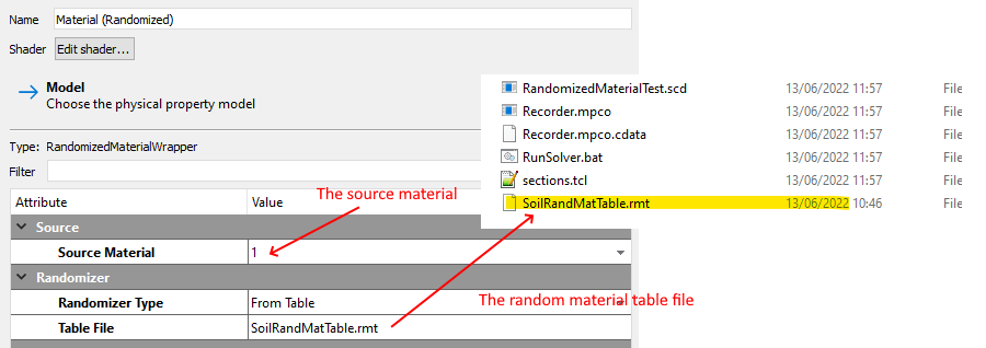

The tool is the RandomizedMaterialWrapper. It is an STKO's wrapper that allows you to select a source nD material, and a text file that represents a Random Material Table. STKO will create modified versions of the source nD material just before running the analysis.
Try to follow these instructions and let us know if something is not clear.
RandomizedMaterial.zip
(70.6 KiB) Downloaded 203 times
In the attached file you will have 2 regions (one for absorbing boundaries, and one for soil elements) and 2 custom scripts required to make the update work correctly. The RandomizedMaterialWrapper only affects the material properties of soil. But the absorbing element should match the corresponding soil elements. This is exactly what those scripts do.
After them, I just put a "record" command to validate the procedure. You can go on with your analysis steps.

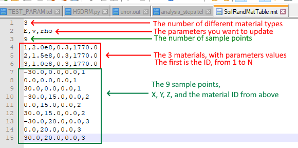

Assume you have 9 sample points from geotechnical surveys...
Define a RandomizedMaterialWrapper for soil elements...
Define the Random Material Table file...

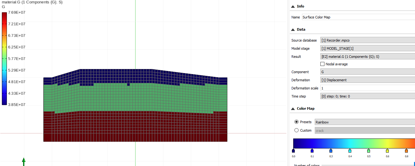

This is what the results should look like

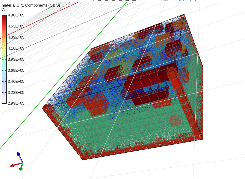

I) Here is a 3D Model (base_3dmodel.scd) I built with the RandomMaterialWrapper, it looks quite nice. As you can see however, the corner absorbing boundaries weren't updated. This is because I couldn't find a way to include them in the Absorbing Boundary selection set with the STKO GUI (If you see the elements.tcl and analysis_steps.tcl, you will notice that the tags of the corner nodes aren't included). I don't know if there is a way to include them with the GUI, but if it's not possible I can do it by scripting or even neglect them.

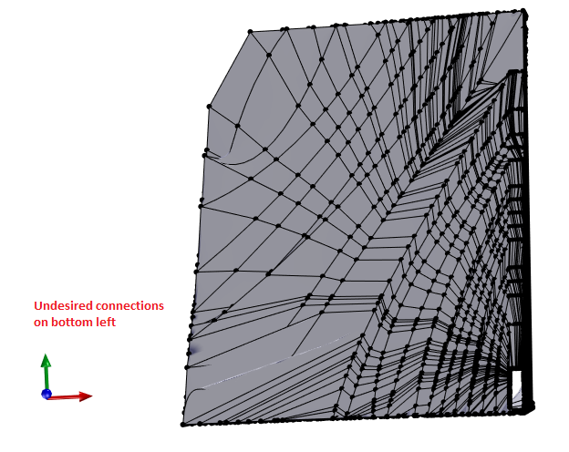

III) The soil model I randomized its a parallepiped so the meshing was straightforward. The top of the model however, is a hill with a lot of irregularities, so I'm having trouble in drawing and meshing layered_topography.scd:
I did the drawing by layers using the Python API and STKO, but it was kind of grueling and prone to errors, and I don't have experience with CAD programs at all. Also, when I try to mesh, even if I have only planar faces, it doesn't create brick elements, what I'm doing is correct or should I find another approach?

You are right, the script I sent you works for the 2D case.
Here's a more generic script. It's even easier because you don't need to create sets: absorbing and soil elements will be recognized automatically from their class tag from OpenSees.
base_3dmodel.zip
(91.35 KiB) Downloaded 218 times

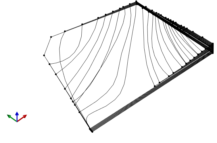

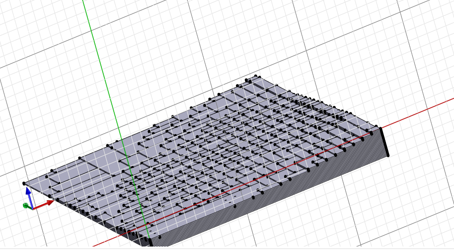

Hello, I found a problem earlier than I thought!
I created smooth splines for each level as you said.
When I join them with the loft command the result gets messy and the volume can not be meshed (I always use the ruled loft algorithm):

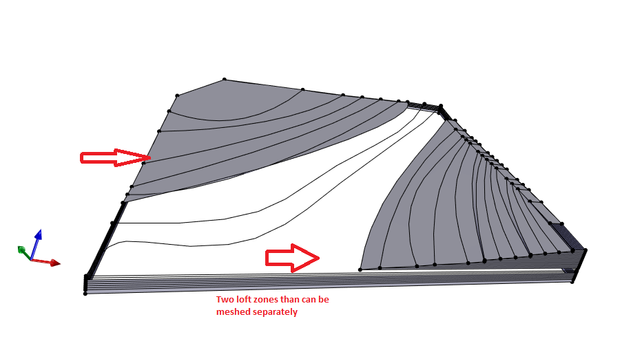

I guess this is because layers are too different from each other, so I worked on some solutions. Here I created two different lofts at the top and the bottom. The hexameshing worked fine for each loft separately, but I could not find a way to join them. Moreover, some layers at the center were too problematic to loft, so I would have to ignore them and change the real topography.

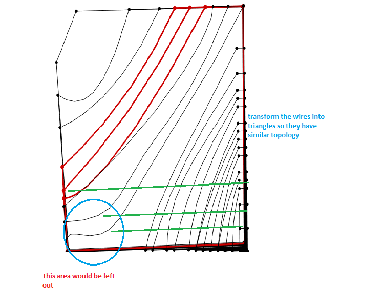

I'm pretty sure the problem could be solved if I cut the lower layers and form triangles (see the green lines in the picture behind) instead of irregular pentagons. Again the problem here would be that I'm ignoring an important part of the topography.
Do you have any suggestions? Should I just simplify the topography? I attach the model with the spline wires.

Post by STKO Team » Mon Jun 27, 2022 9:09 am
The curve levels should not be done in this way. Some of them cross each other. Others are overlapping at the same Z Coordinate.
This makes the Loft process non-unique.
However, we are adding a new feature that will be released soon. It allows you to create a B-Spline Surface (free-form) from points or curves used as constraints.
In the meanwhile, I used our tool (work in progress) on your model. I had to clean some of your iso-curves to make them consistent (no crossing and no overlap).
Here I obtained a surface that passes through your curves.
Then I extruded it to make a volume.
Let us know
