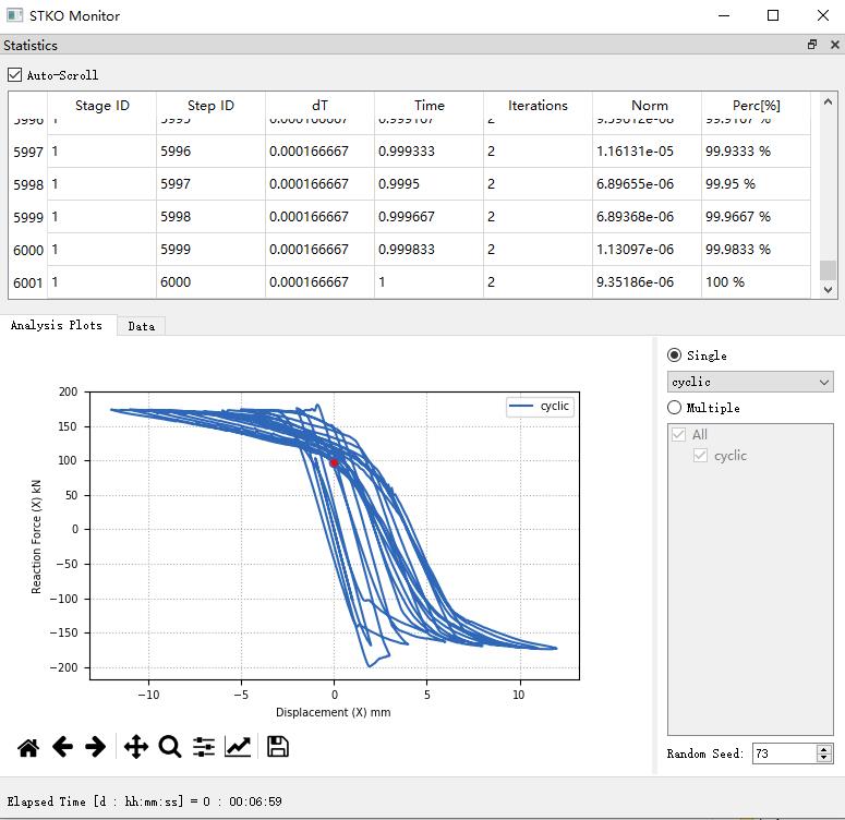

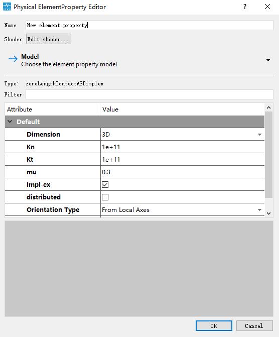

Thank you very much for your reply and for debugging this model. May I kindly inquire about a few more questions? What is the effect of setting the Y-axis to "Sum" and "average" on the load. I ran your modified model to get the displacement reaction force curve. The displacement reaction force curve proceeds from the negative direction, whereas the cyclic cycle load applied to the top beam is loaded first with the positive displacement. Can you help me to find the reason for this. Also, what is the basis for setting the values of Kn, Kt and mu for the zeroLengthContactASDimplex element, and what conditions can be based on. Thanks again for your generous and enthusiastic help.

Sum option would add up the reaction forces from the SP constraints at the base of the model, whereas Average option would sum up the reaction force and divide it by the number of nodes where it recorded the reaction forces. So, you need the first one to get to see the total applied load (horizontal) on the structural system.What is the effect of setting the Y-axis to "Sum" and "average" on the load.
You can change the direction by setting/modifying the -factor in the definition of time series to -1The displacement reaction force curve proceeds from the negative direction, whereas the cyclic cycle load applied to the top beam is loaded first with the positive displacement. Can you help me to find the reason for this
Dr. Massimo presents a nice explnation about the contact element and associated parameters in the following webinarAlso, what is the basis for setting the values of Kn, Kt and mu for the zeroLengthContactASDimplex element, and what conditions can be based on
https://www.youtube.com/watch?v=tXA5guozrFU
