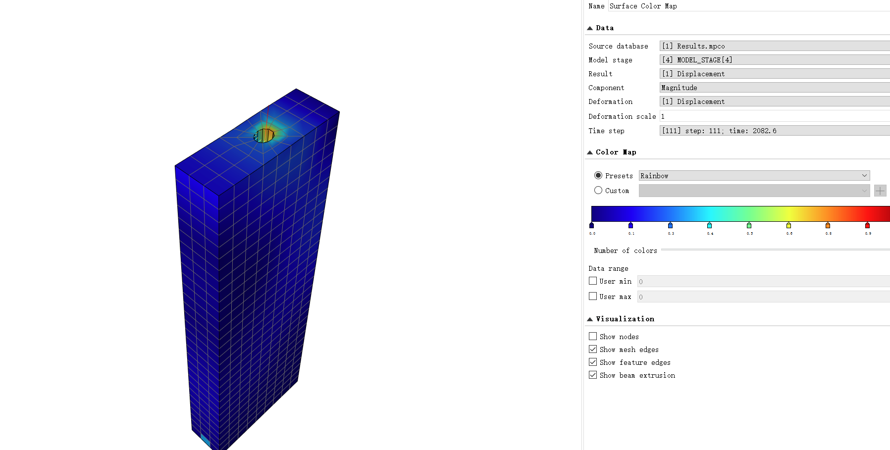

I built the model step by step from your webinar video, but when I finished the analysis, I loaded the results, I only could see the line represented the pile. I assigned the section to the pile. What should I set in the postprocessor?

Make sure "show beam extrusion" is turned on in the surface plot options.

Post by spater » Mon Dec 13, 2021 6:53 am
I turned it on but it still invisible.

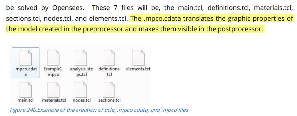

If you created the model from the STKO pre-processor, and you used an MPCRecorder analysis step (not manually via TCL scripting" you should have a file with the same name of your mpco recorder, but with the mpco.cdata extension.
Can you verify you have it? otherwise the beam extrusion won't be visible.

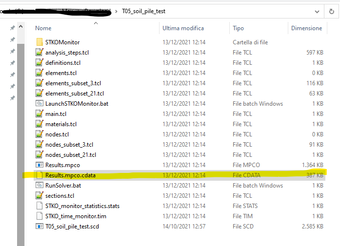

Post by STKO Team » Mon Dec 13, 2021 11:16 am
I know. Do you have the .mpco.cdata (the highlighted one) file in your directory?

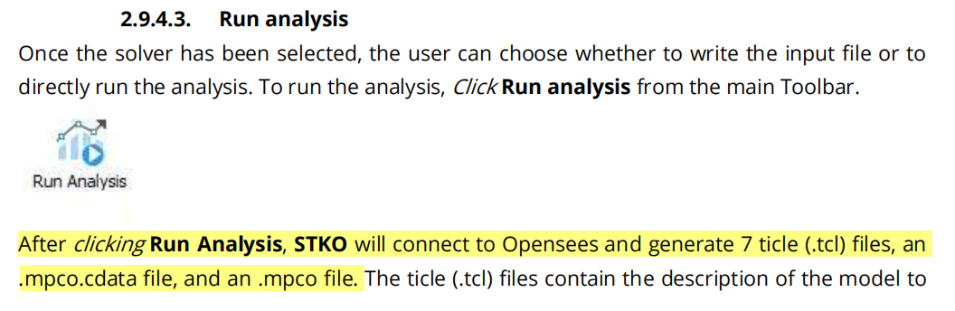

Post by spater » Mon Dec 13, 2021 12:49 pm
I don't have this file.
I found the description of the ".mpco.cdata" file in the STKO manual. But when I finished analysis, it didn't creat this file.

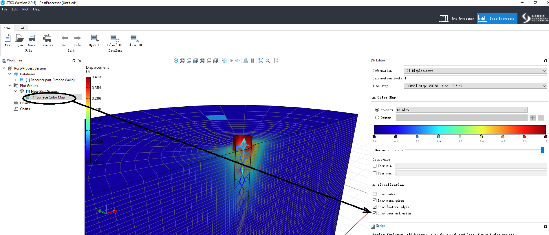

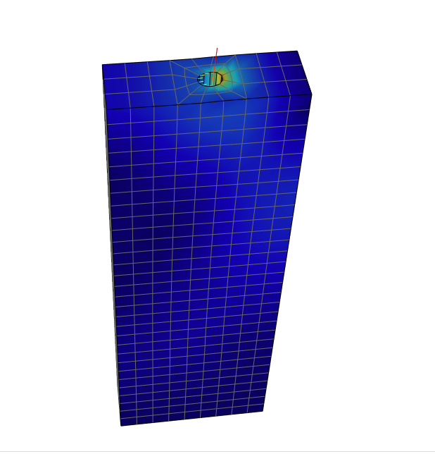

Post by spater » Wed Dec 15, 2021 9:20 am
I re-downloaded the file from the official website without making any changes, but it is still the same.
Eventhouht there exised a ***.mpco.cdata file, I still can only see one thread.
Attached is my operation screen recording, please help me solve this problem, I am really anxious.
Thank you very much!
